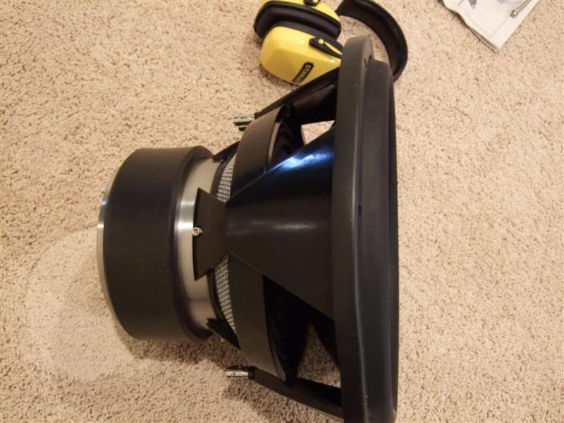

I still have no idea where I will put everything. I may have to run it to a closet since it's kind of ugly.
I am trusting Andrew and Chris on the need of it. Since I am doing this, I want to go all out on it (except for the fact that I am not going to spend 1k+ on amps).
Save cash...what does that mean...I can always make more money:rolleyes:

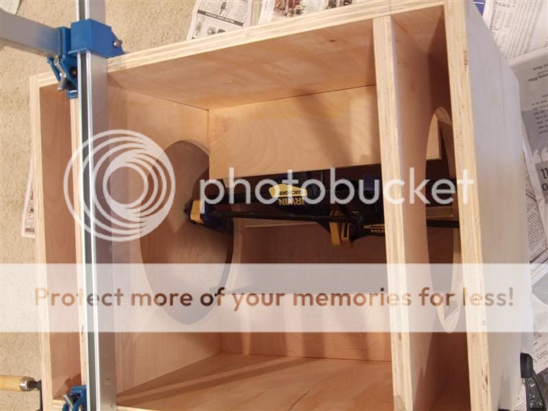

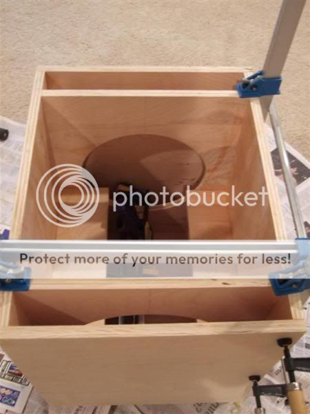

Andrew has been hard at work as he complains about how cold it is outside.
Looking pretty good. :D
Just don't forget to play that Shockwave scene in Transformers blu-ray.:D
Warpdrv
Warpdrv
Looks great.... that will be a fantastic sub, good bracing there, should be plenty solid... :)
Can't wait to see more, keep the pics coming buddy... :)
