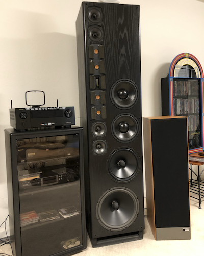

I'm using 7' tall VMPS SuperTower III's for mains. They already have 15" drivers that offer nice bass but setting them up in Audyssey with a 40Hz crossover and sending the bass below 80Hz to the HSU VTF-3 MK5 HP added a nice kick. I set the sub volume to 9.5 and used Audyssey app to set the levels. I had to go thru the process a few times to get the volume on the sub just right to register the HSU VTF-3 MK5 HP at 0 db in the Denon levels with Audyssey. Once that was setup the auto-on function works and I was able to boost the sub to between +3 to +5 db on the fly using the iPad Denon receiver app. This makes it easy to control bass output in realtime to meet any musical content.
90% of my use is music. I usually have the sub set at +3db on the receiver but it's so easy to change the level wirelessly with the iPad that I find myself boosting it to +5db for Aquaman, Blade Runner 2049, Remnant and other massive bassaholic content.
Each SuperTower III has 13 drivers :D
I mount the Canton Vento Reference 9.2 on top of the 7' Tower - it adds a 7'' Aluminum midrange and a 1'' aluminum ceramic oxide tweeter. This combo adds a nice high frequency color to the overall sound. Call me crazy!
That is one strange speaker. Clearly the designer didn't regard comb-filtering as a serious problem, but in fairness, the research into the audibility of comb-filtering has shown that human hearing is pretty insensitive to it up to a point. The vertical dispersion pattern of that speaker must be absolutely surreal. Speaker design has come a long way since those were made. It would be interesting to hear one.
With Vento Ref 9.2 mounted on top of the SuperTower III this vertical wall of sound climbs over 8 feet. Using the Vento as a quasi tweeter on top of the SuperTower III reminds me of a GIANT version of my legacy B&W 801. That HSU sub adds considerable oomph to the dynamic bottom end. I was surprised that even when the main speakers are built with 15" drivers sound quality is enhanced considerably with HSU subwoofers.
