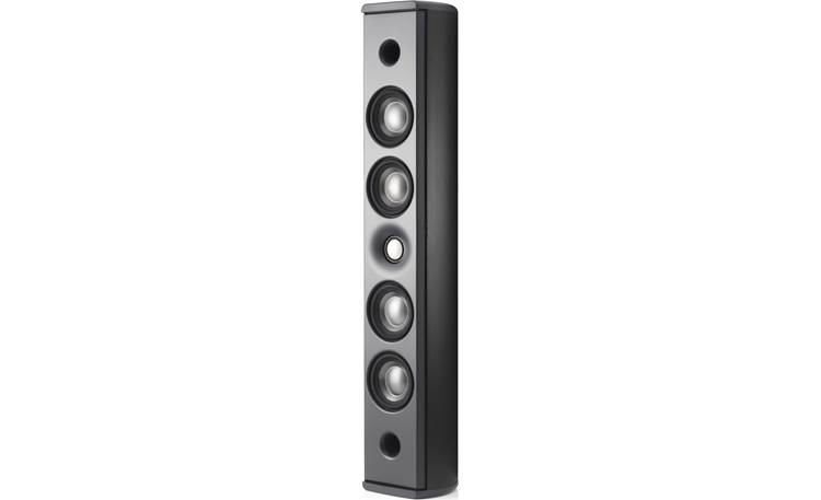

I get that. I'm talking size and frequency response. Those particular models appear to be tiny and more geared around mounting for small unobtrusive bars beside a TV. Low end is only 110hz. The others I'm looking at have extension much lower. Like I'd be leaning towards something like a Canton Veno 836.2 or Reference 9.2 if I could figure out how to properly mount it on the wall. :)

I get that. I'm talking size and frequency response. Those particular models appear to be tiny and more geared around mounting for small unobtrusive bars beside a TV. Low end is only 110hz. The others I'm looking at have extension much lower. Like I'd be leaning towards something like a Canton Veno 836.2 if I could figure out how to properly mount it on the wall. :)
I only searched on wall. If the speaker is rear ported, mounting them on the wall won't work unless you plug the port (which will raise the 3db point considerably
