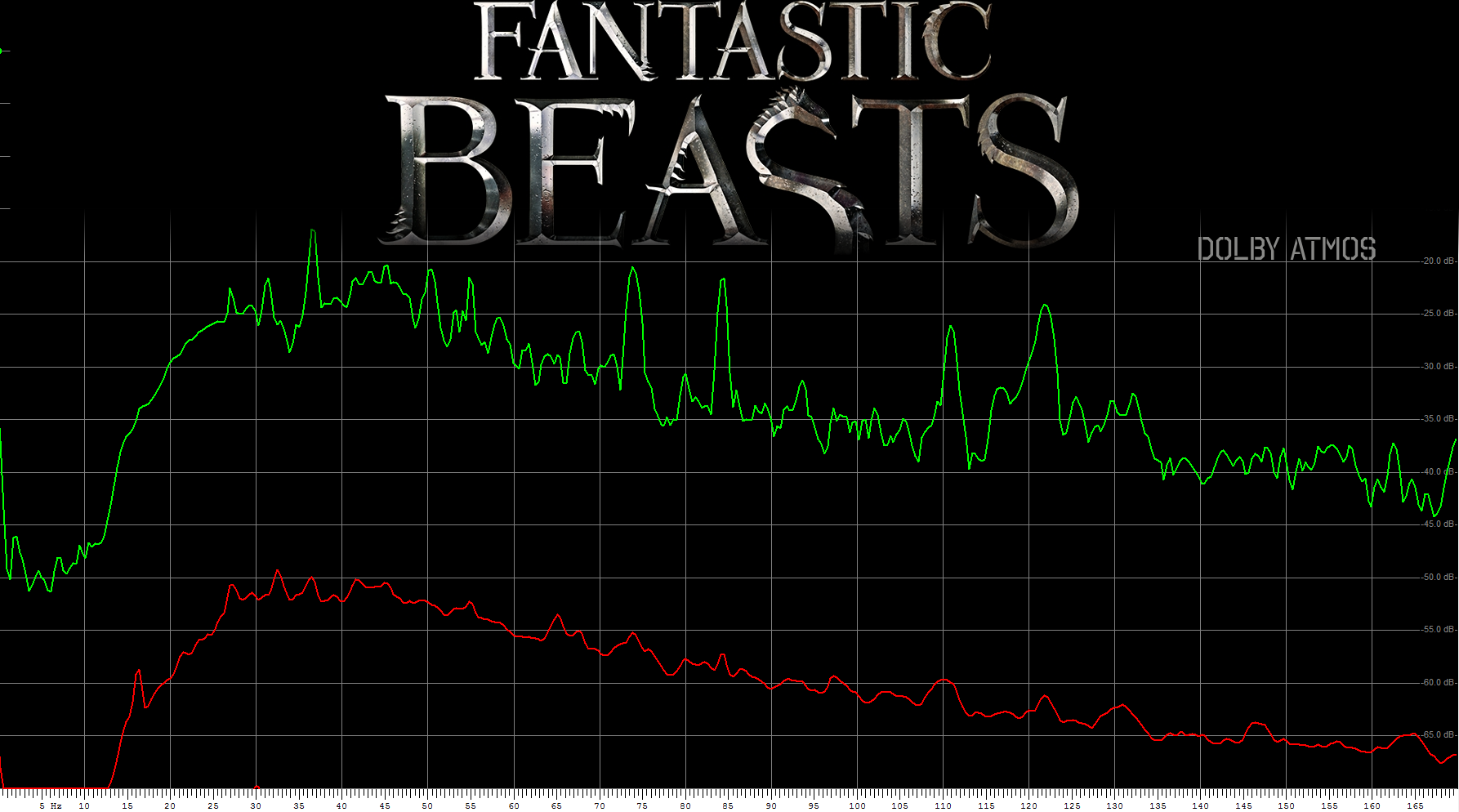

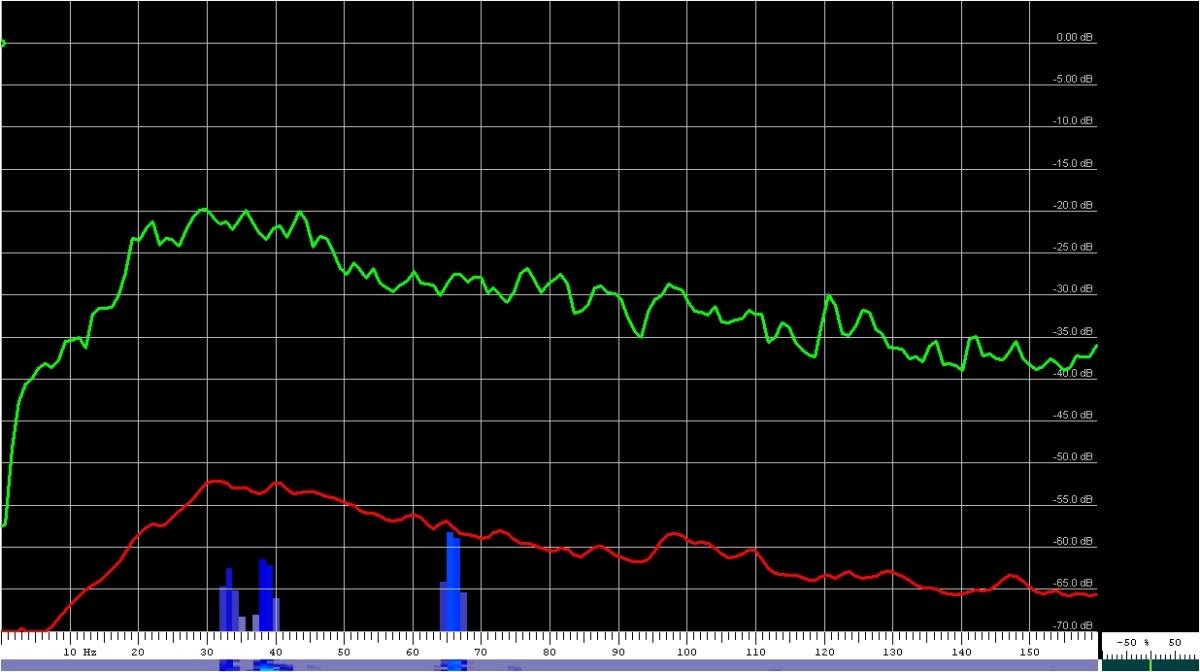

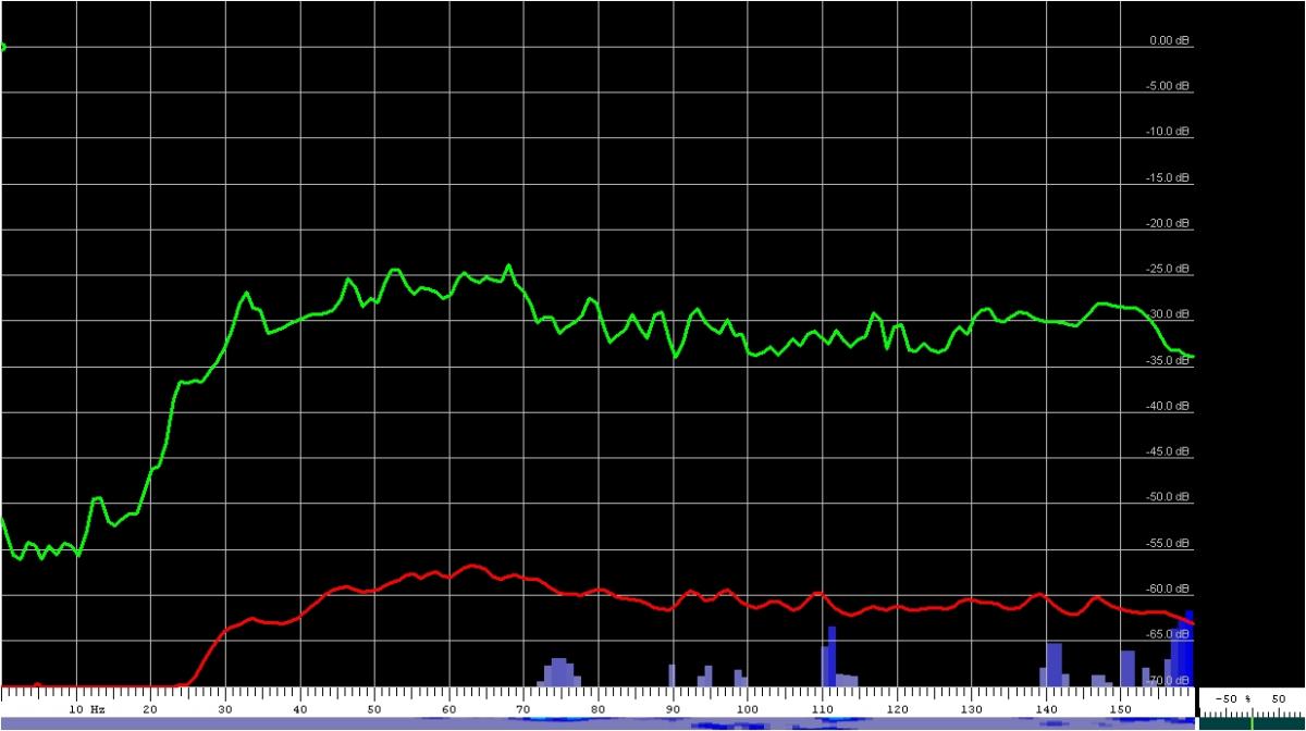

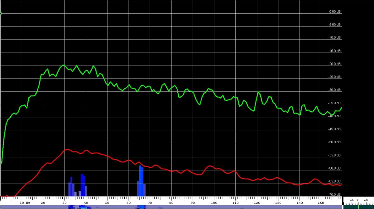

Are you familiar with any of the Harry Potter films? If so, can you think of a scene where +30 Hz is truly an important component to the presentation, and so when it's diminished (via a sub that can't deliver at that range) one loses a part of the "experience" of being in the movie?
Here's a frequency chart of Sorcerer's Stone:
One for Half Blood Prince:
And one for Fantastic Beasts:
I think its fair to say that in all 3 tracks, bass over 30Hz plays a pretty significant role in the soundtrack. As shady/James said though, the question is about dynamic range / how loud you care to listen.
I have seen those FFTs before, and the problem is, what time duration are they covering? Is that the spectral composition of the entire movie or just a scene? Or just a brief moment? Those FFTs dont mean much unless you know what is being measured.
Steve81
Steve81
Audioholics Five-0
They're billed as for being for the entire film.
