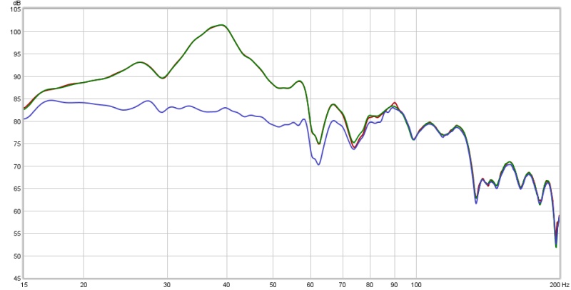

So I looked up and I've got a Denon AVR-688 that has Audyssey MultEQ.
I've also attached a graph that shows the before (green) and after (blue) from REW.
First I was like :) since you did a great job bringing the green to blue results...

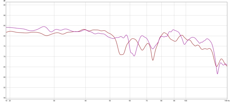

I set the sub crossover to 250 Hz (max available) and set the Denon to "Direct" and disconnected all my other speakers. I ran a quick test in REW and didn't see any difference in the plot.Through Receiver vs Direct Both EQ.jpg

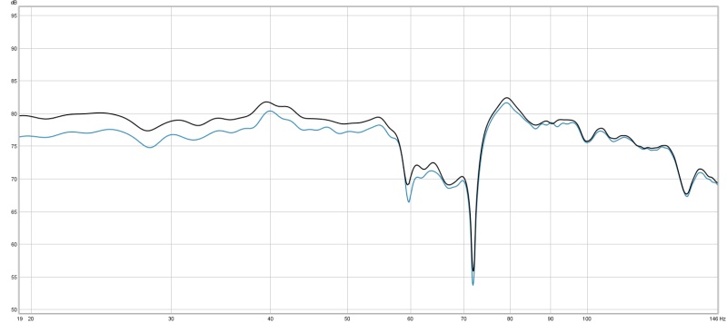

Then for fun I took measurements in the same six locations that I calibrate Audyssey (see plot). Through Receiver Six Locations.jpg
Overall the response seems fairly similar in all the locations, especially below 50 Hz.
Since I was in the system I tried doing a little tweak to improve my movie going experience. I added a little EQ at 19 Hz, 3 dB, Q 0.5 just to extend the bass a little. The measured difference doesn't show much but when I watched Fifth Element it was pretty good.
