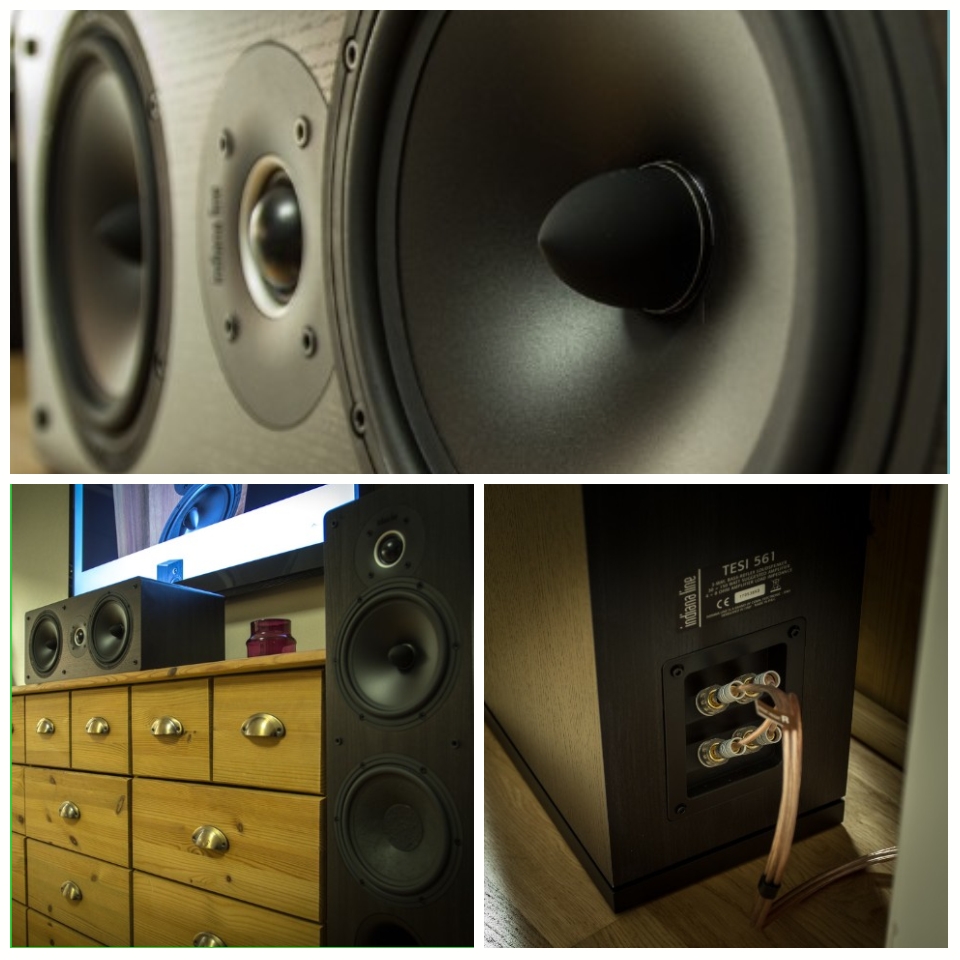

sometimes I notice some strange hi-frequency sound, like the tweeter are popping but it looks more by the av side, like it can't handle a good quality performance, it happens at high volume as low, most when there is lot of speaking, radio talking in movie or live concert. With flac/cd music, like jazz or other with few instrument, no problem.
I'm really happy by all the system, but this small thing make me think a little bit

My first thought would be physical damage to a driver. Is it coming from all of your speakers? Just one?
