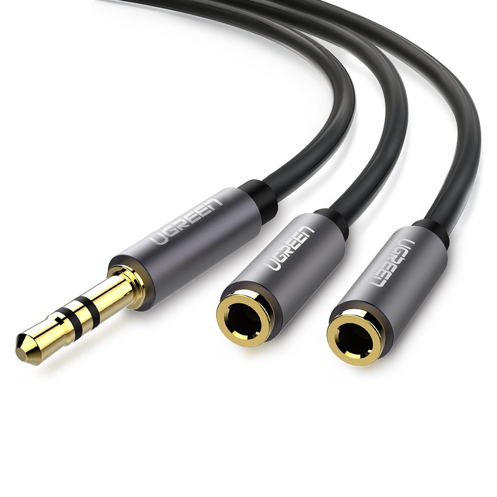

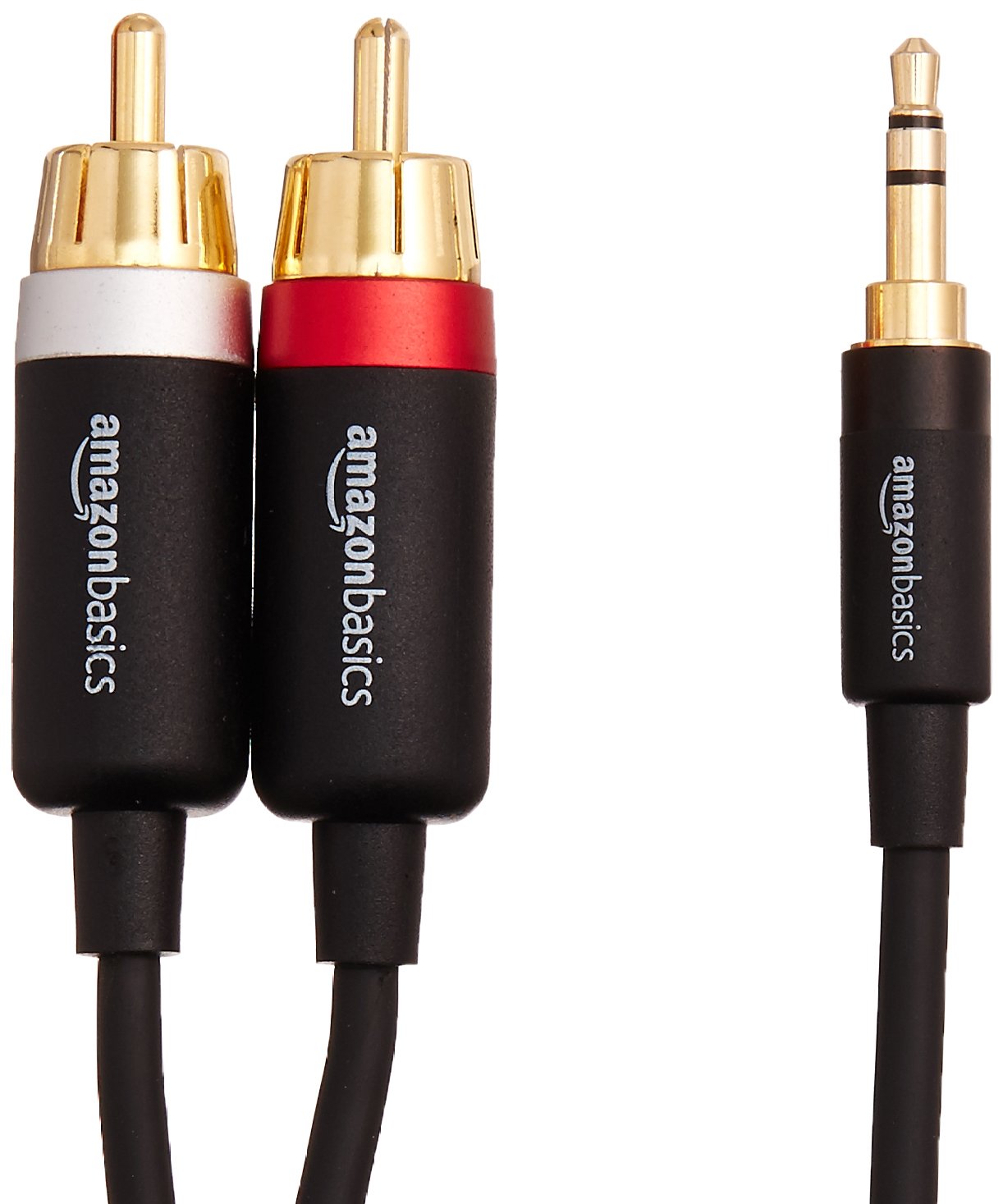

thank you, the schiit fulla-2 seems a nice product. if am to go for it, that will be the only thing i need. isn't so.? will that be enough? i would really like the subwoofer added.
Yes, it will be enough to add the sub by splitting the variable out from Schiit using this cable,
and two of this cable,
