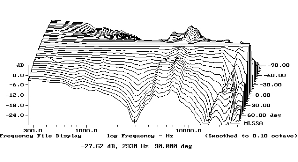

Looking at the D7 measurements, I wonder if has anything to do with rise in output in the 2-4K range and the hole in off-axis dispersion in this range. This would result in a lot of direct sound and not as much reflections, and sound "crisper" in short auditions. But I think long term with so much direct sound (versus reflected sound) in this range it would sound lacking in air and/or spaciousness.

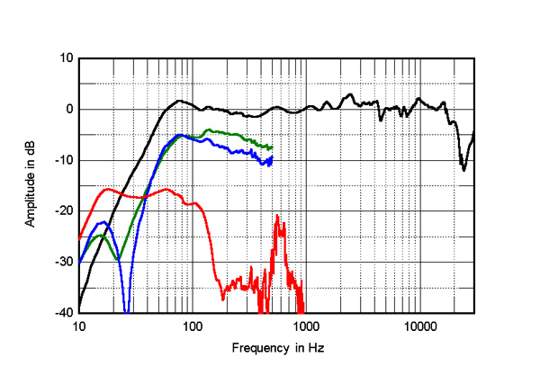

The Spendor D7 and Spendor A9 measurements are mediocre at best, and their prices are absurd relative to their performance.
I don't know about the D9, however.
https://www.stereophile.com/content/spendor-d7-loudspeaker-measurements
https://www.stereophile.com/content/spendor-a7-loudspeaker-measurements
Nice on-axis response, but the directivity control is sorely lacking. The reason is clear, much too high of a crossover frequency for those cone sizes. 3.7 kHz going from a 7" midrange to a 1" tweeter!

Yep, a 7" midrange should necessitate a tweeter than can cross over lower than most.
If I remember right, it's not even quite a 1" tweeter. They use 22mm Seas tweeters, smaller than the more common 27mm tweeters. So that makes a bad choice of driver combination even worse.
They also have significant problems with port resonances, bad enough that they show up in the on-axis response.

A 7" midrange pretty much necessitates a horn-loaded tweeter or something with a serious waveguide, and even then crossed over at a much lower frequency, like around 2 kHz I would guess. I am sure Spendor's rationale for their design is that they don't want a crossover anywhere in the mids because they think it would create disconnect in this heavily trafficked frequency band, to which I would say just make a good crossover, or better yet, make a three-way with a smaller midrange if you want such a high crossover frequency. The $70 speaker -that's right, $70 speaker- I am reviewing right now puts this thing to shame regarding directivity control!

Isn't the D9 just the D7 with an additional woofer and a different crossover to make it a true three-way?
If so, it still has the questionable combination of a 7" midrange with a 22mm (<1") tweeter crossed at somewhere around above 3.5kHz, ie, it sill will have really poor off-axis response.
