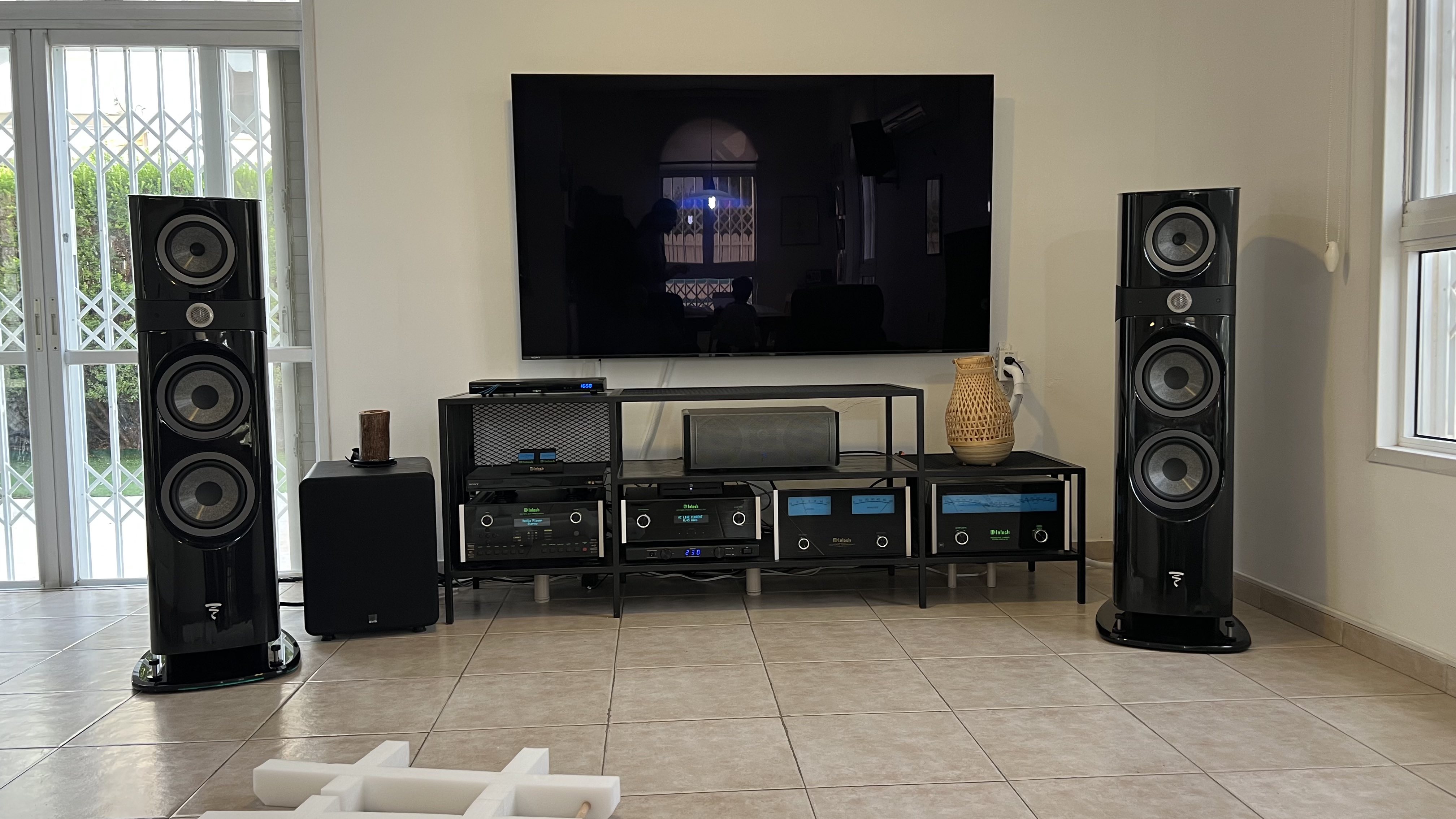

mantime here is my living room.
No need to reply or comment on my post unless you really want to go far afield of the goal.
I can already surmise several issues you likely have.
The extent to which you want to address them is up to you.
You will determine your own level of involvement.
Please do a Clap Test in your room. Walk around a little bit and clap your hands.
Listen for the echo.
This is one of the first things you should consider solving. I see a lot of hard, reflective surfaces which means you likely have a lot of Slap Echo. This will manifest as a ringing quality in your room at mid and higher frequencies.
Gorgeous speakers my man and those Macintosh amps!!! SEXY!!! Great choices!!!
I would keep the rubber feet do not use spikes on tile or wood flooring
Your going to need a nice big area rug in front of that set up also heavy drapes on all those glass sliding doors and windows ESPECIALLY that window to the right by your speaker. That's a lot of bright reflective surfaces in that room. Luckily heavy drapes rugs and furniture should do the trick I had a similar room siruation in my old house with my setup

Agreed. Rubber feet under those speakers will be just fine. The purpose of spikes under loudspeakers is mechanical – they keep speakers from moving if they are on a carpet. Those speakers are unlikely to move no matter what kind of floor you have.
Most of your other questions, such as speaker cables, binding posts, after market speaker spikes, bi-wire or bi-amp set ups, etc., all involve superficial aspects of audio gear, at best. At worst, they're expensive jewelry, without a real function.
Don't read those audio web sites or magazines. They're full of paid advertising from the makers of that overpriced stuff. Don't get swept up by their nonsense.
You now have very good but very expensive speakers and electronic gear, as shown in the photo. Perhaps the audio dealer who sold it to you is trying to steer you in the direction of buying more audio jewelry from him. If so, ask him if his profit from the speakers and electronic gear wasn't enough. The profit margin from exotic speaker cables is huge compared to those speakers.

Another thing. If there ever was a room that could use some acoustic treatments, this is it.

Don't waste any money on anything other than room treatments and placement of equipment. Gorgeous pieces there, but you could not have put them in a worse location in a more compromised room if you tried. Pics of the entire room would be helpful.

with tile, room treatments are definitely going to benefit you. WAY more than power cables :)
agreed 100%, there is so much wrong with that set up ! Focal's are superb speakers, they deserve a much better environment. I too, given the quality of your equipment find it hard to believe your Audio dealer didn't do a better job of helping you out, shame on them !

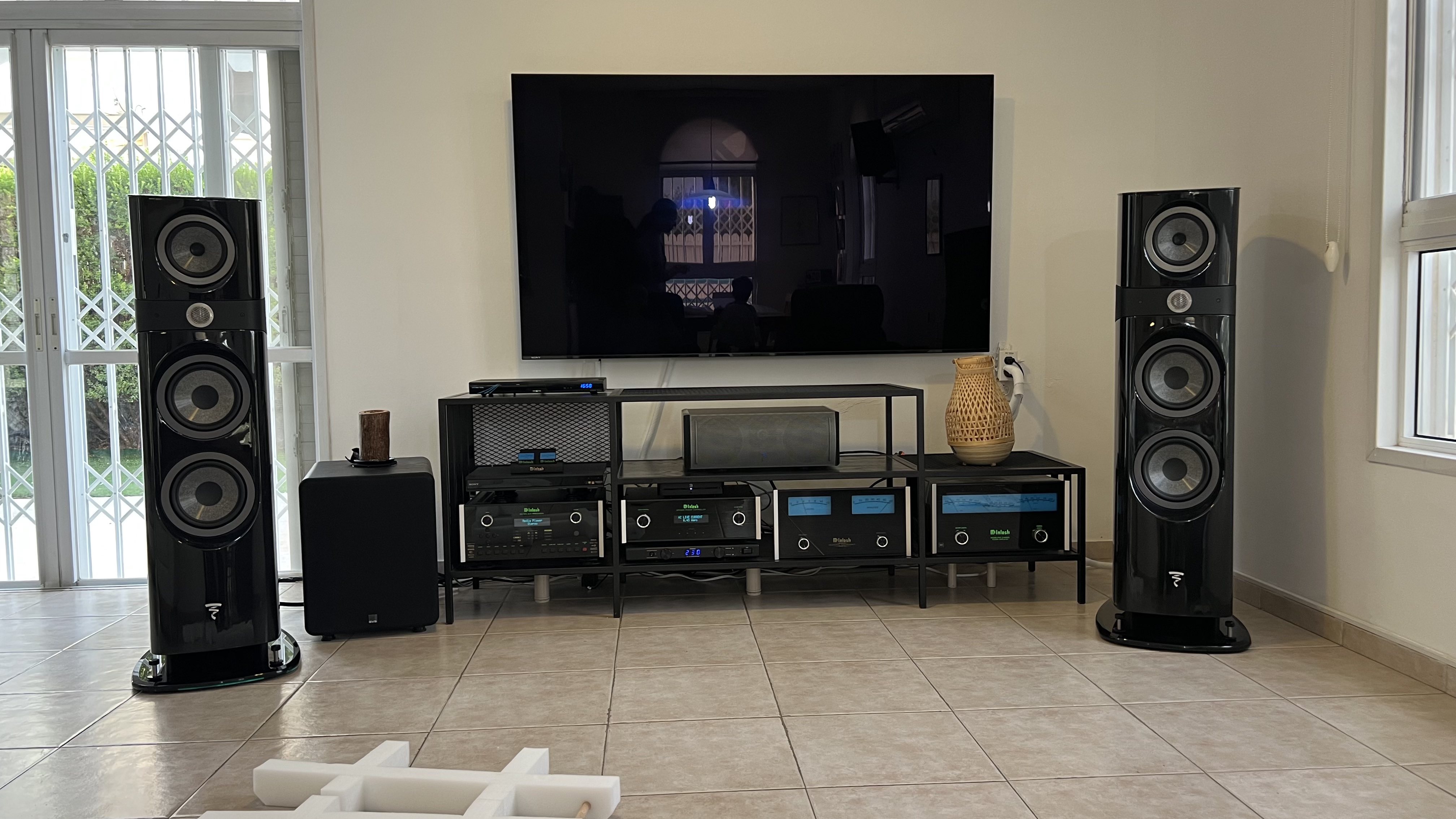

Hi all .
As promised , I'm replying. ....
I know that the room is not compatible to Audio especially with a Macintosh and Focal.
I live with my wife. this living room also hers , She doesn't want any changes or additional furniture or a CARPET.
She " agreed " to my expensive Audio gear. That's fine with me.
No other option available.
