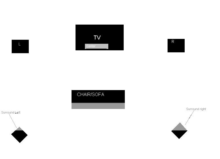

NO, connect all the speakers to the CORRECT outputs. place them like this or forget using a sound system.
zhimbo
zhimbo
I have to say I can't make heads or tails of how the system is actually laid out - the front speakers, the most important speakers, are in a different room from the TV? If so, there's no mystery why there's some difficulty getting the sound right. You might as well turn the TV upside down and wonder why it's hard to tell what's going on.
Prevtzer: If you can't get something roughly approximating that layout pictured, forget about making a surround system work. Get a good pair of headphones, switch to a simple stereo layout, etc.
I think you're trying to get your surround speakers to do the job of your front speakers AND your center channel as well. If so, you should just admit you're running a 2 channel setup, and arrange things for a 2 channel stereo setup.
