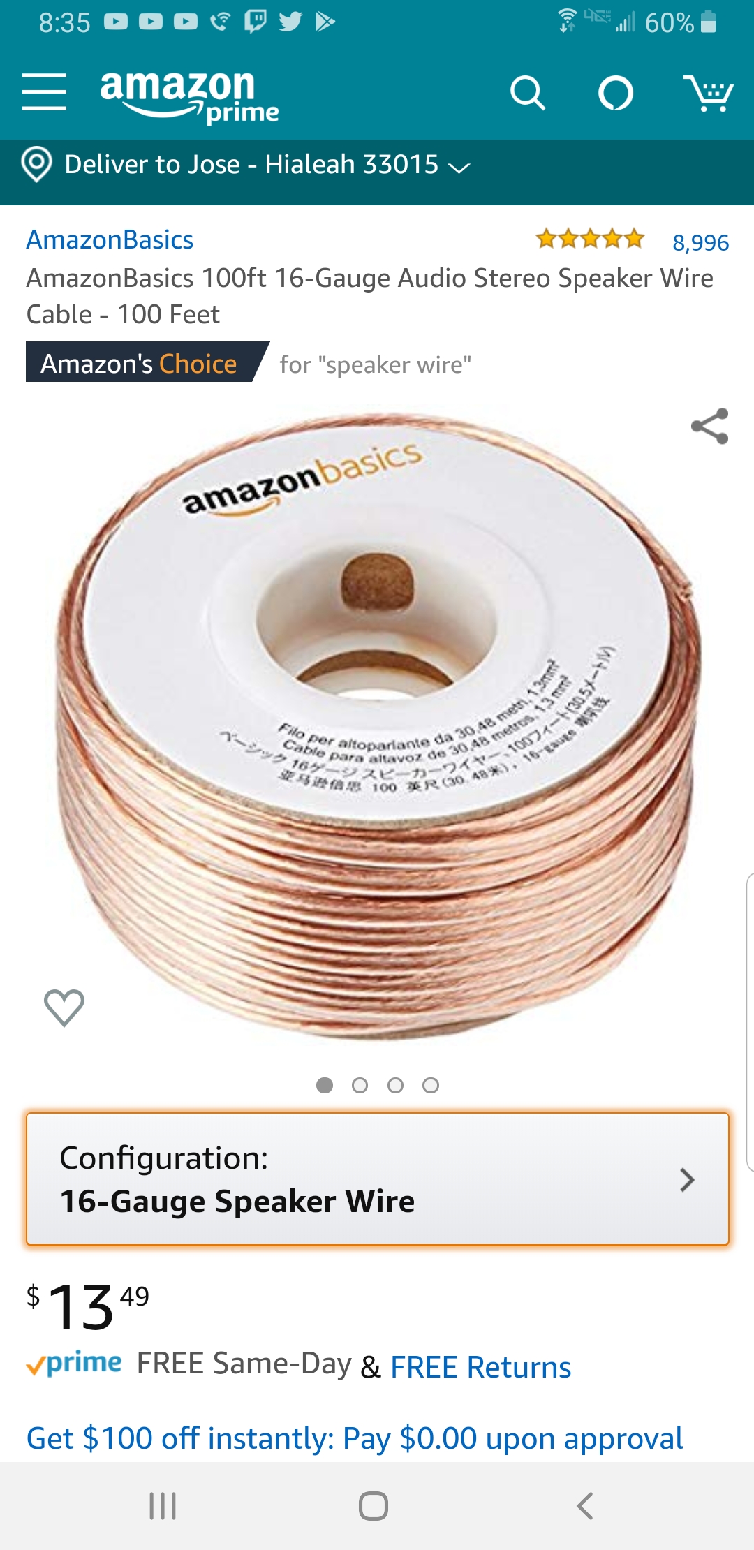

Hi there.
I was looking online to purchase speaker wires but I see cables with different gauges. Which type of cable would suit what I'm looking for?
Thank you

Scroll down just a little bit and you will find a list of gauges and lengths. Many people buy from Monoprice and Blue jeans cables. Whatever you do don't buy in to the snake oil which comes with expensive speaker cables with some costing thousands. Any wire of the proper gauge is all you need and the sound quality will be the same as expensive wire. You can even buy speaker wire cut to length at Home Depot. I'd go there before Best Buy.

Just get copper cable. As to gauge, there's a guide:
I tend to just get 12ga in spools because it's reasonably cheap and works for any realistic length / ohm combination I'm likely to use.

Just in case you don't know, make certain it's stranded and not solid. For Shorter runs 14ga is usually more than adequate with 2-8 ohm speakers. Let the chart JerryLove posted be your guide.;)

Don't spend the money on Copper Clad Aluminum.
Good quality Copper (as in ALL-Copper) is readily available at very reasonable prices.
