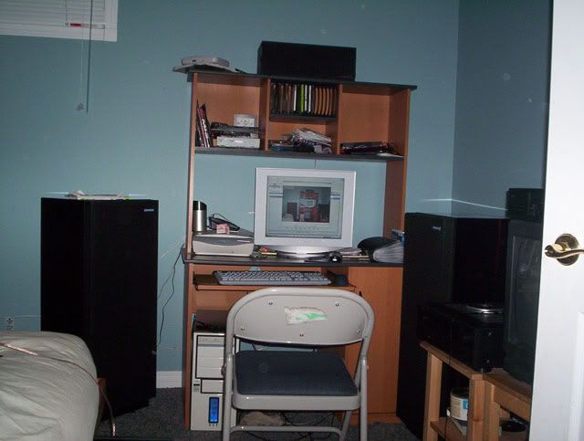

So I moved all of my speakers on and beside my desk, because im going to use my sound system for my computer alot more then my TV for the summer, at least untill the house is built.
Here is a picture of the new arragment:

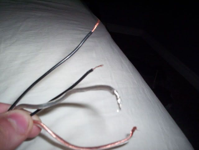

And here is a picture o two sets of wires, the ones on the rigt are the wire that I use for the other speakers and te ones on the left (the black ones) are attached to the speakers i hope to use as surround speakers.
I cannot change the wire because it is in the speaker cabinet.
I am just going to hook this black wire up to my Denon, like I have with all of the other ones (not using banana plugs).
Im worried about the guage of the black wires. Will it be ok with my Denon AVR-1705?

What kind of speakers are you using for your surrounds? Some small PC speakers or something? I can't think of any "HT" speakers with the wire attached, save Bose. I would think the wire should be okay, but what about the impedance of the speakers?

How long is the run? Can you read the gauge on the wire?
From the looks, it should be fine.

On the wire it says alot of things, but i think the guage is 24, the wire says, in two places:
"AWG 24"
Impendance is 6Ohms.

Ew. 24ga wire = mega resistive loss. But, unless you feel like taking apart the speakers, you're stuck with it. The good news is it won't be bad for your Denon. In fact, it will increase the resistance the amp sees, so no worries there. If you're worried if it will come off or something, try tinning the tip before you attach it to the binding post.

It will be fine as long as you keep the length shorter than 6 ft.

Well...I got it set up....
And, its GREAT! What a difference two more speakers can make! (at least now, I had a setup like this a long time ago, but thi one is by far better)
In Rush's "Countdown" (Signals, 1983) there is a chopper that flys by. It now flys from the front to the back, as opposed to front left to right! :)
The speaker wire is very secure in the receiver, as of i tightened the banana plug terminals quite a bit.
