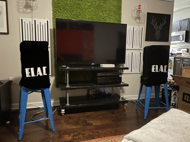

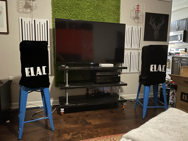

@pcosmic i try to avoid discussions on this site regarding cables/dacs/amps/what have you because there is a prevalent (and sometimes justified) mindset against such hooliganism. My own experiences are to the contrary, though and such things can (not always) make a difference (and this is important) in my system.
That being said and since you rock the Adante line, I thought I would share a truly sad picture: you see, it is moving weekend and my own have to go back into the box for a while...
Yes, discussing things that are based on only subjective opinions isn't really what this site is about.
