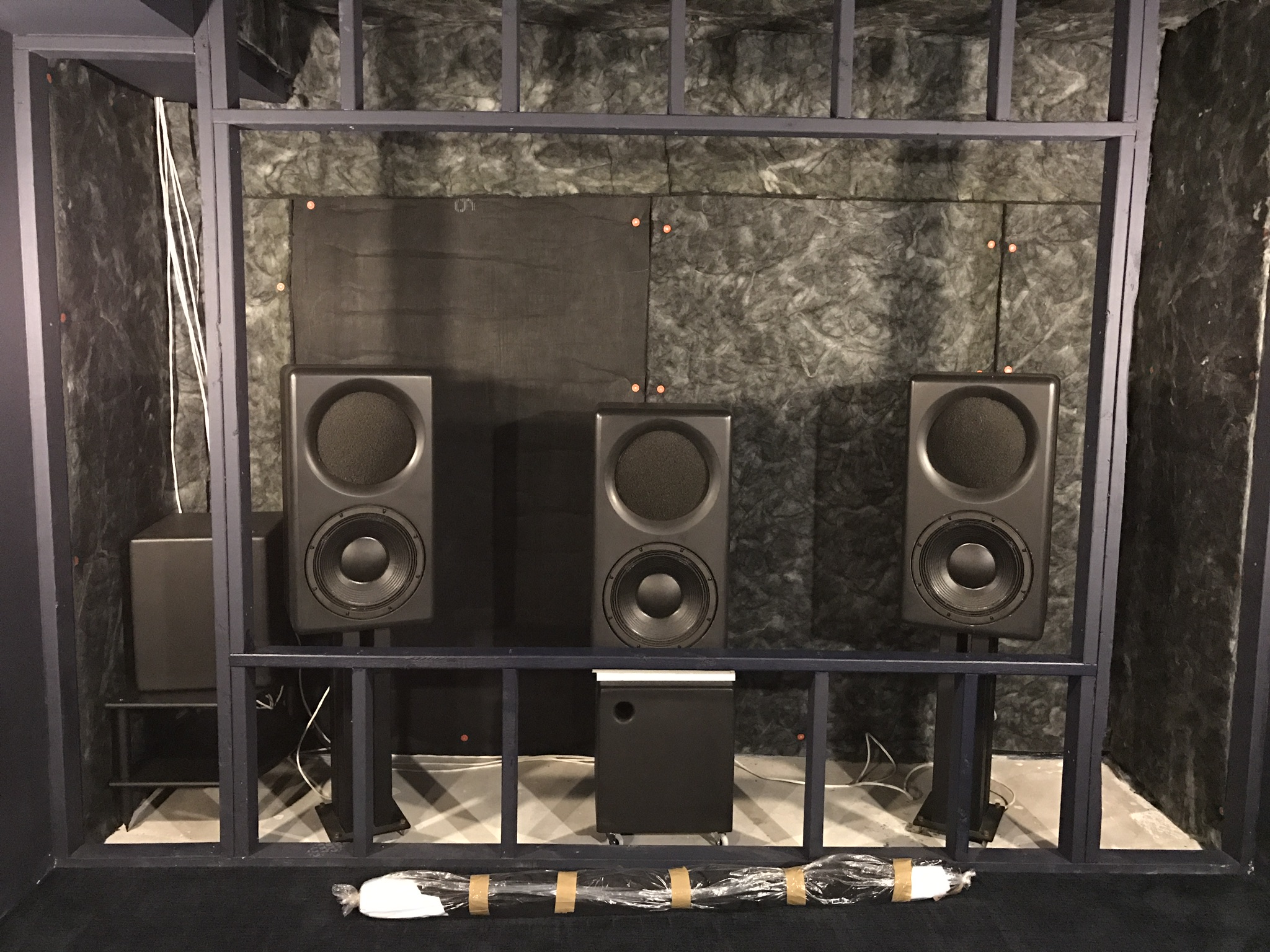

Here is the front stage of my theater. The frame is all 2x4’s and the speakers are a controlled directivity speaker with a 90 degree dispersion (response is down 6dB at 90 degrees). I placed the speakers to the outside edge of the frame and I had the edge of the frame profiled and then I put some insulation around it. I also insulated between the spans of the frame and all the panels where there aren’t speakers.

Here is what it looks like closed up.

Here is the front stage of my theater. The frame is all 2x4’s and the speakers are a controlled directivity speaker with a 90 degree dispersion (response is down 6dB at 90 degrees). I placed the speakers to the outside edge of the frame and I had the edge of the frame profiled and then I put some insulation around it. I also insulated between the spans of the frame and all the panels where there aren’t speakers. View attachment 27639
I totally agree. I'm not asking because I think there is a problem, but because its the perfect time to learn and understand better! besides, this is the best time to fix it if there is something wrong. :cool:
Nice set up! who makes the speakers? (Not that I'm in the market, anymore. ha!)

Earl Geddes made them. Gedlee Abbeys with custom crossovers. I built them from kits that Geddes supplied, but were available as completed speakers too. They aren’t available anymore, Geddes is retired.
