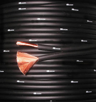

OK. Now I have another question. The speaker wire itself. It used to be that any good quality copper wire was fine. I used to just buy spools of 16 gauge wire from Radio Shack for around $20. Now I hear people spending $200 or more just for wire! Is this just hype? I find it hard to believe that they've somehow invented better more conductive miracle wire.
BMXTRIX
BMXTRIX
Tons of posts about this, but definitely hype.
16 gauge though may be a little small. Look at 14 gauge at least, perhaps even 12 gauge depending on how much power you need to move.
I bought my stuff on eBay and got a very good value, but places like www.bluejeanscable.com have good stuff as well.
jaxvon
jaxvon
Shaddow Ferret, some reading material:
Cable Stuff.
That should answer some questions. Yes, those people are crazy. But as BMXTRIX said, heavier guage wire will be best.
