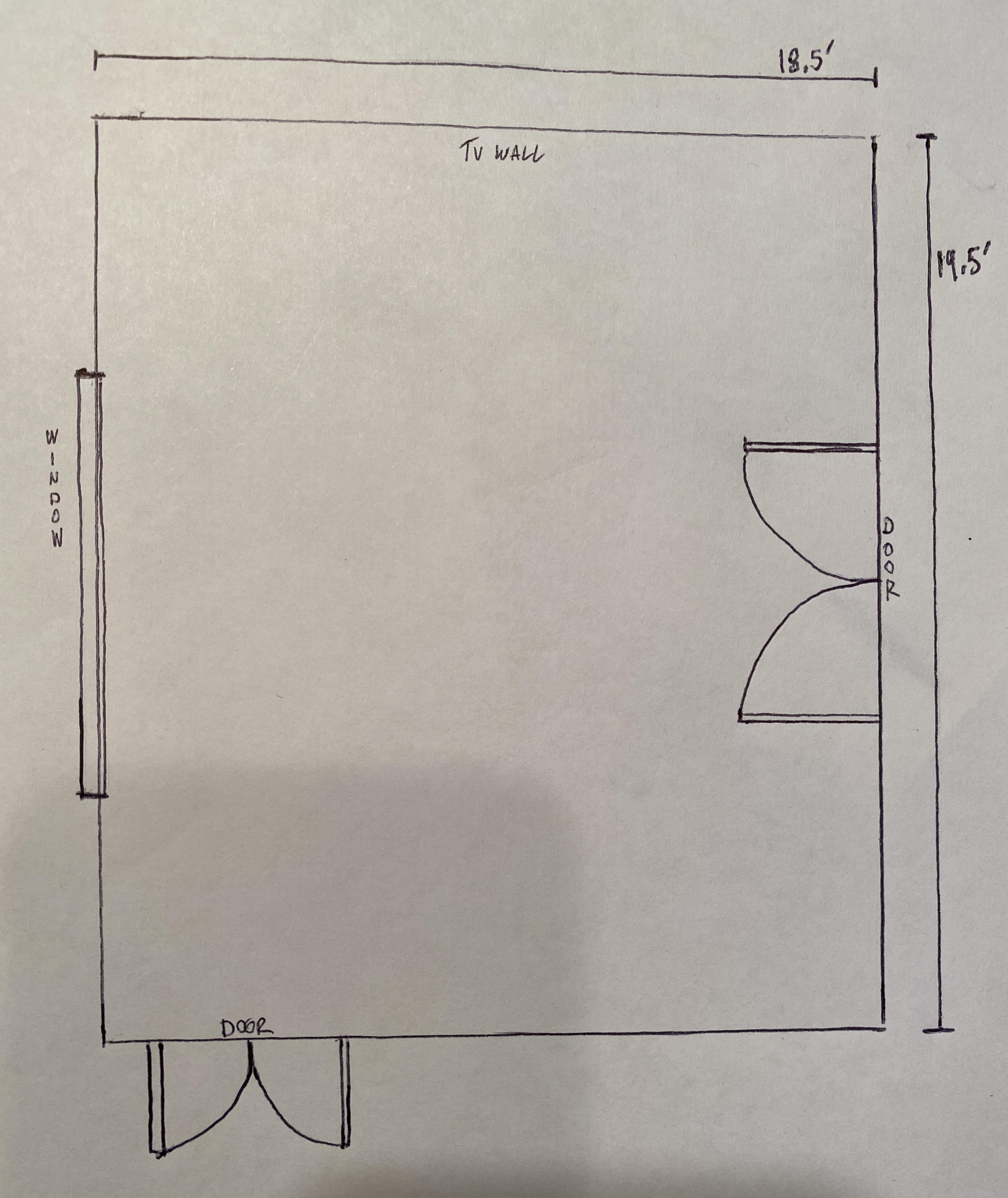

Looking to go with the Marantz SR6015 to power a 5.2.4 home theater with two SVS SB-1000s for low frequency. The room size is 18.5’ x 19.5’. With 9' ceilings for about 3,246 cubic feet. For the remaining speakers I’m looking at the following configurations;

I would appreciate any and all feedback. Thanks in advance and please let me know if you have any additional recommendations!

I don't see a good place to mount in-wall surrounds in a 5.1.4 set up in that room. The reason is that they can not be aimed to face your listening position, since you would want to mount them the corner of the room. I would take regular bookshelf speakers and wall mount them in the room corners to face the listening position. I think there is a chance that the sound system will be a bit goofy since you have so much emphasis on the Atmos height channels but not the bed layer which is so much more important. You might just think about skipping height speakers entirely.
