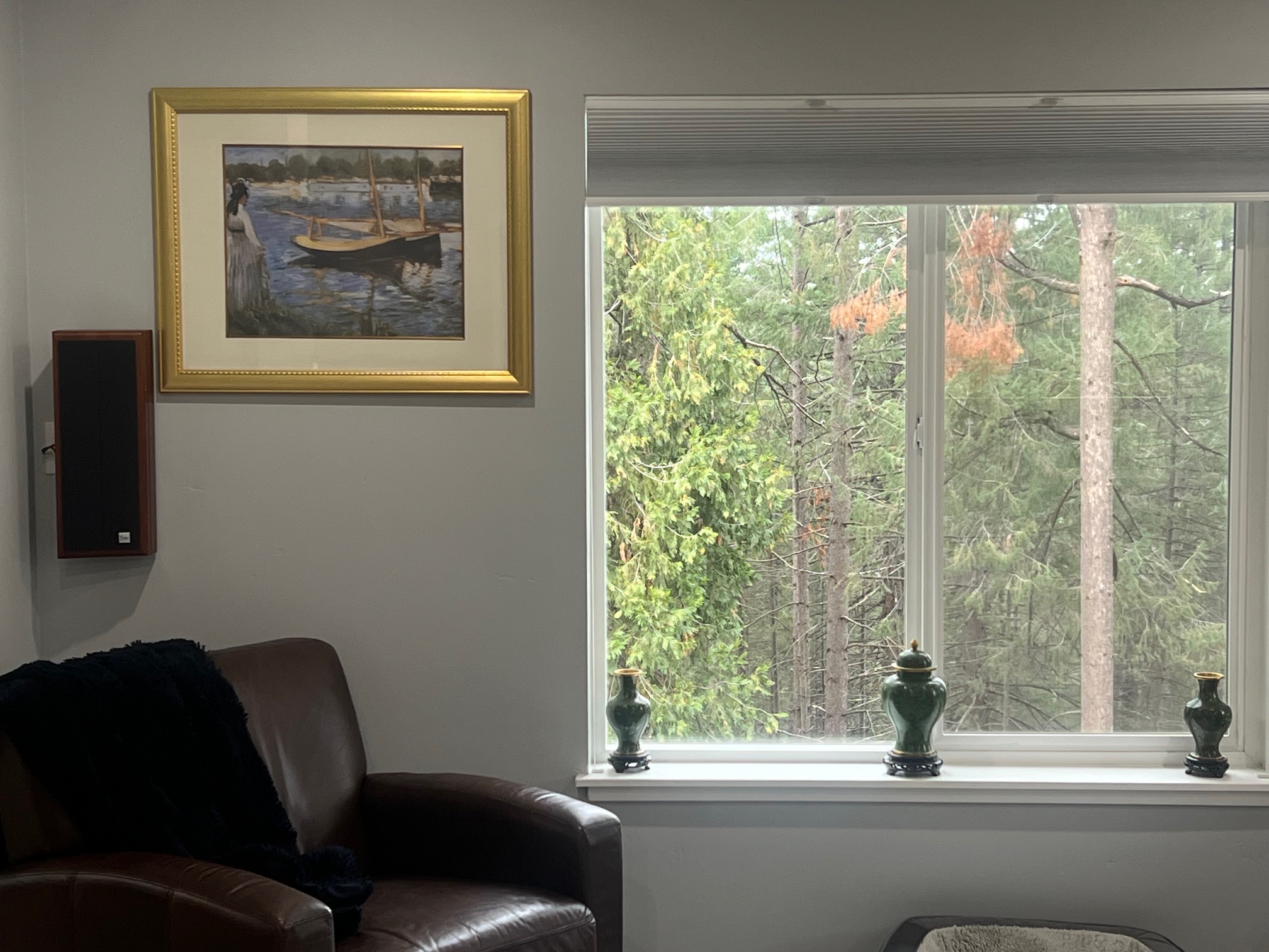

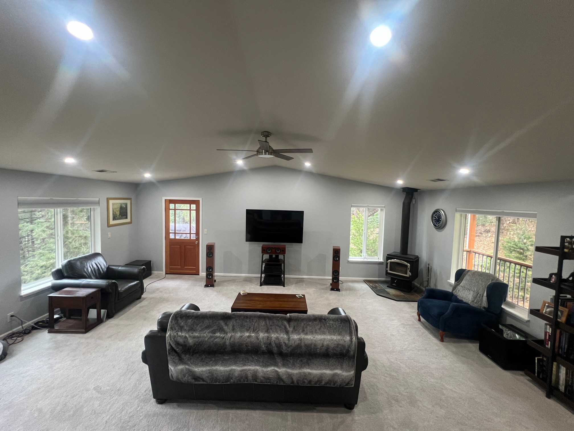

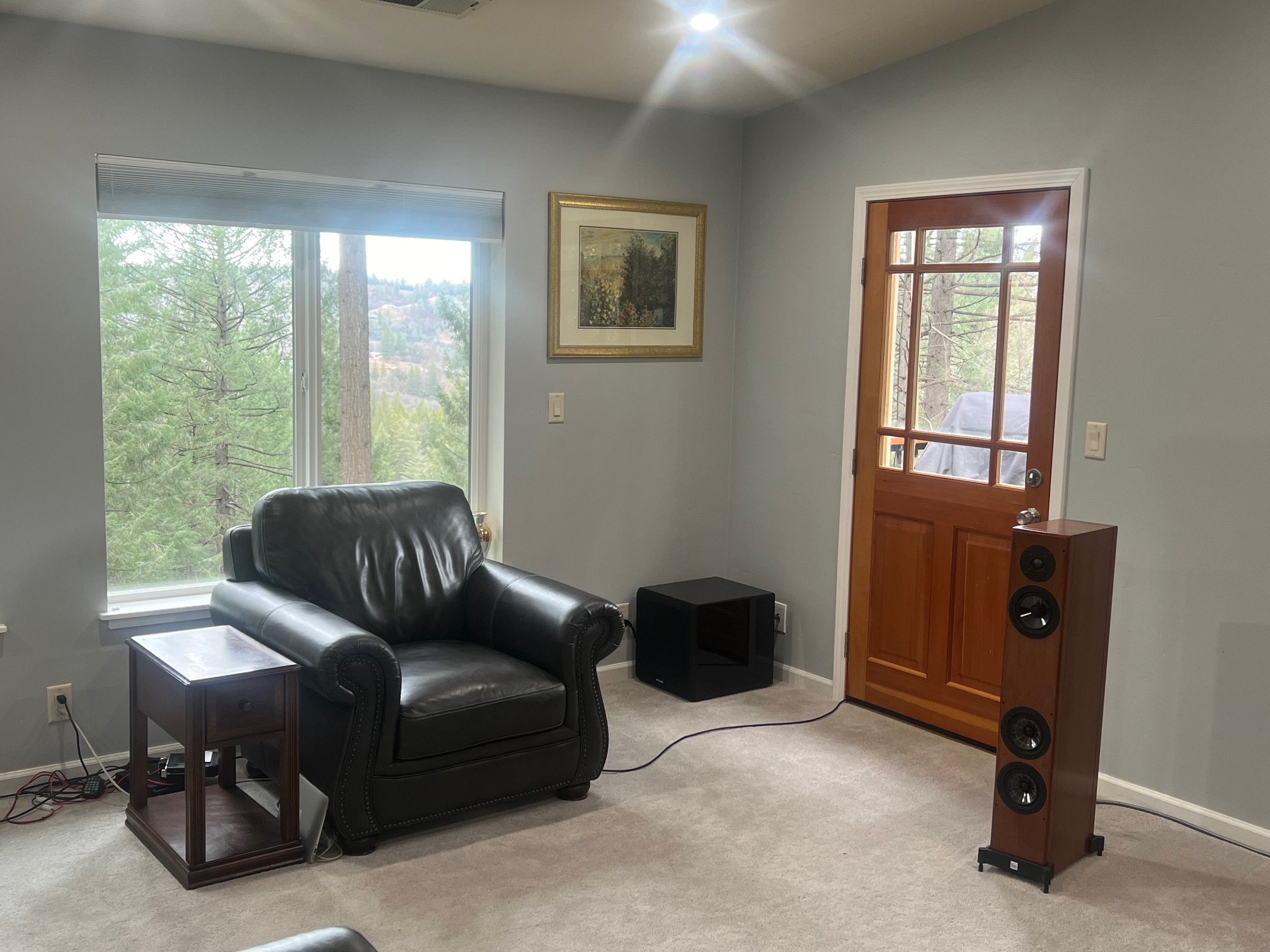

New to the forum. Hopefully I can contribute, where appropriate.
I recently moved and finally got all of the speaker/xlr wires buried in the walls. I've got my subs in a fantastic location, where they completely blend with the mains perfectly. Rears are mounted and time-aligned (ARC Genesis). Fronts sound good, center imaging is there, but the soundstage is only about 90% there. In my old house (much smaller room) I was able to get that effect where they completely disappeared. Now, there's just something that I can't put my finger on. The L/R is noticeable. I put them on coasters and tweaked them to death, but I'm missing something here. I can move the couch back a couple of feet, and I can move the speakers out another 6" before my wife... well, you know. I'm hoping you all might have a couple suggestions based on my setup. I'll try to include as much detail as possible...
Equipment:
Mains: Vienna Acoustics Beethoven Baby Grands
Center: VA Maestro Grand
Rears: VA Waltz Grand
Subs (2): Rythmik Audio F12SE
AV: Anthem MRX540 (Processing movies and power to ctr and rears)
2 Channel: Parasound Halo Hint 6 (Utilizing Theater Bypass for Movies)
Bluesound Node 2i with Tidal Hi-Res
ELAC Sensible Speaker Cables
Audio-Magic Excalibur SHD Interconnects
Room: 24' Wide x 41' max - (Stairwell wall is 26')
Ceiling Max: 10' 11"
Front of speakers are 2' 7" from back wall / 9' 8" apart / 10' 10" to listening position
Lastly, the reason it took me so long to join a forum is my avoidance of snobbery. I'm looking for a solution to my problem (and to contribute to a group). I've grown weary of "Oh, I wouldn't sell Vienna to my worst enemy!" and "If it's not McIntosh, throw it away". So if you don't like my equipment, thank you.... it's what I like, and to me, that's what this hobby is about. I have many hobbies and I have to spread the funding accordingly.
Thank you for any input you may have.

At a guess I'd say simply the difference in room acoustics, though and if you've done what you can without changing gear....hard to know what you think you remember let alone what you're experiencing over the internet. Perhaps just running your ARC again...
  • Agree
Reactions: ryanosaur
Nothing strikes me as out of whack by your description.
My thoughts are that you might want to redo your room correction sweeps and adjust some more. You pretty much seem to already suspect it is the new room. I agree with this.
In terms of the other stuff you discuss, you only invite push back by doing so. You have gear you like. Period. It worked to good effect in your previous setup. That’s fine.
Other than room size, what else changed? Do you have less stuff in the space? More reflective surfaces?
I suspect you can work your way back through the differences and perhaps come to a point of resolution.
Perhaps you will need to do something about the reflective surfaces all around. The ceiling and naked walls with widows just scream for some attention.
Mind, I’m not suggesting you hang panels everywhere, but the room itself is likely very live.
Just my thoughts on it without being there to experience it.

First, I would double-check the wiring and polarity to the mains. A phase issue there would definitely explain imaging issues (though usually means no center image).
Second, I would test sitting in a more nearfield position to see if you get a better imaging effect. You wouldn't want to spread them apart much wider (in my opinion at least), but if nearfield does work better I would take to be a room boundary/interaction issue. That could be difficult to find a good solution too, but maybe a little farther out into the room and moving the MLP up a little closer might help.
Have you done any sort of RT60 test? Even a simple clap test to see how much echo is in the room? It's large with a peaked ceiling and mostly hard surfaces on the walls. A lot of delayed reflections are going to smear any soundstage you get too. I suspect the distance to your physical rear walls will be helping in this case, but it's worth checking anyways.
Oh. And there is nothing wrong with your equipment :) I'm running a 7.2.4 VA system myself and while they have a voicing, they still sound great. They're biggest failing is they don't like to be pushed too hard.
gene, welcome aboard ! I'm in agreement with others in that your room is the culprit. For one thing it appears the windows are smack dab at the first point of reflection. At a minimum start their with maybe a heavy blanket to see if there's an improvement ?
I say experiment with one variable at a time until you get it dialed in

For the room, it's one of those dumb-dumb realizations. I moved from a dense neighborhood to overlooking the forest. I think I was so enthralled with the daily view that it completely slipped past me that I have giant sound mirrors all around. All glass has double cell blackout shades, so I'll pull everything down and see what difference that makes. Thank you for the head slap on that one. I will also look into performing the RT60 test.
I did move the couch about a foot closer and it helped bring things in. However, I've read in a few places that these speakers are quite tricky to place just right. That's where I was looking for suggestions. I was hoping someone had experience to say that they're too far apart, need extreme toe-in, no toe-in, something that I'm just missing. Movies sound great, but they're movies. I also probably shouldn't have even mentioned sound adjustment as that was simply for movies (the Anthem). 2 channel is processed directly through the Parasound.
The room here is significantly larger. Before I was crammed into a 12' by 15' space. I'll start looking at reflections, and maybe my ears just need to adjust to the new space.
With that, how do you all deal with the balance of a "living space" and acoustically perfect setup? Am I the only one that would be sleeping in the garage if I tried to hand acoustic panels from the ceiling? She often jokes that she's going to replace everything with a Bose Acoustimass system while I'm at work.

We all have to make compromises in our situations. That's the very nature of life if we aren't fortunate enough to have the perfect space which can be dedicated to nothing else. ;)
Blinds are one thing: next step is hang curtains. Even left open they will help break up the room a little, but if you really want to sit in dreamland with your favorite recording, closing the ones at the front of the room will have a significant impact.
A further step that would be minimally invasive would be to perhaps put some acoustic panels behind the front Speakers. Suggesting this is a bit tricky as we don't know exactly what may be happening in your room, but treating that front wall a little bit could help with some of the reflected energy.
To that point, this is where getting your hands on a measurement mic and REW (room eq wizard) can be very helpful. You don't have to be a pro acoustician to use it, though there is a bit of a learning curve. Folk here can help interpret graphs if you have questions. But for the cost of a microphone (about $100) you can start digging in to what is happening in your room and understanding what might be needed to make the changes that will aid you in your goal.
A follow up though re room size... A larger room should be easier for the Speaker to "disappear" in. That's the theory, at least. But consider that in the smaller room, you were likely enveloped by all that energy concentrated and moving around you. In this new room, you don't have the same boundary support and thus the acoustic issues are different and questing for the same experience as before may well be challenging.
FWIW, I'm in a very small room, too, 11x15'. When listening in stereo, I get a quasi-surround field because of the way all that sound moves around and stays in my room. The designer of my Speakers and I have discussed some of the effects I note about my mains and one aspect of difference is his listening environment where he fine tunes his designs is larger. Short version, he doesn't necessarily agree with me about the effect I experience. ;) This isn't a bad thing, it's just different. :)
However, the moral of this is that if I were to set up in a larger room, I would undoubtedly lose the effect I currently enjoy in my small room.
To that point, I don't really like the idea of saying the Speakers "disappear." While I get the concept, I think what you and I both experience(d) in our small rooms is more about envelopment of energy. If you look up an old video that made some waves on various fora about how to place your Speakers so they disappear, posted by New Record Day, he gives his process for finding that right spot. (Not saying I agree, but just some "food for thought." :p )
For him, as I recall, he needed to pull the Speakers pretty far out into his room to achieve this. Of course, leaving them there isn't an option. But again, this goes some way to showing the every room will be different and the things that worked before won't necessarily work now.
Perhaps you'll find something in all of this to help out further.

You could try raising them up off the floor a little bit. Getting the tweeter a little above your ear level is the goal. You could also try angling them down a bit as well if possible, depending on how much you raise them.
I know the Baby Grands aren't mean to be raised, but sticking something like a cinder block or two under them for a quick test might be worth a go. My guess is your ceiling height has gone up in the new place as well, so playing with the vertical ratios might help.
I recently did something like this with my bookshelves in the small system. I went from 29" stands to 36", with another 6" angled desktop stand lashed on top to angle them back down a bit to more of a seated height again. I did this more to get them to better clear some obstructions (monitors, audio rack) in a cluttered space, but do think that the result sound bigger than before as well.

I agree about room acoustics, just noting the expanses of glass. I'm a fan of heavy curtains in an audio space.
Those main speakers look small in that room to me, regardless of how they spec, and in spite of what current trends indicate to the contrary.. In that situation, I would set up the mains in a 2-channel stereo near field and work my way out from there, just to learn what the mains are capable of in that room, and how far, before they start petering out.
