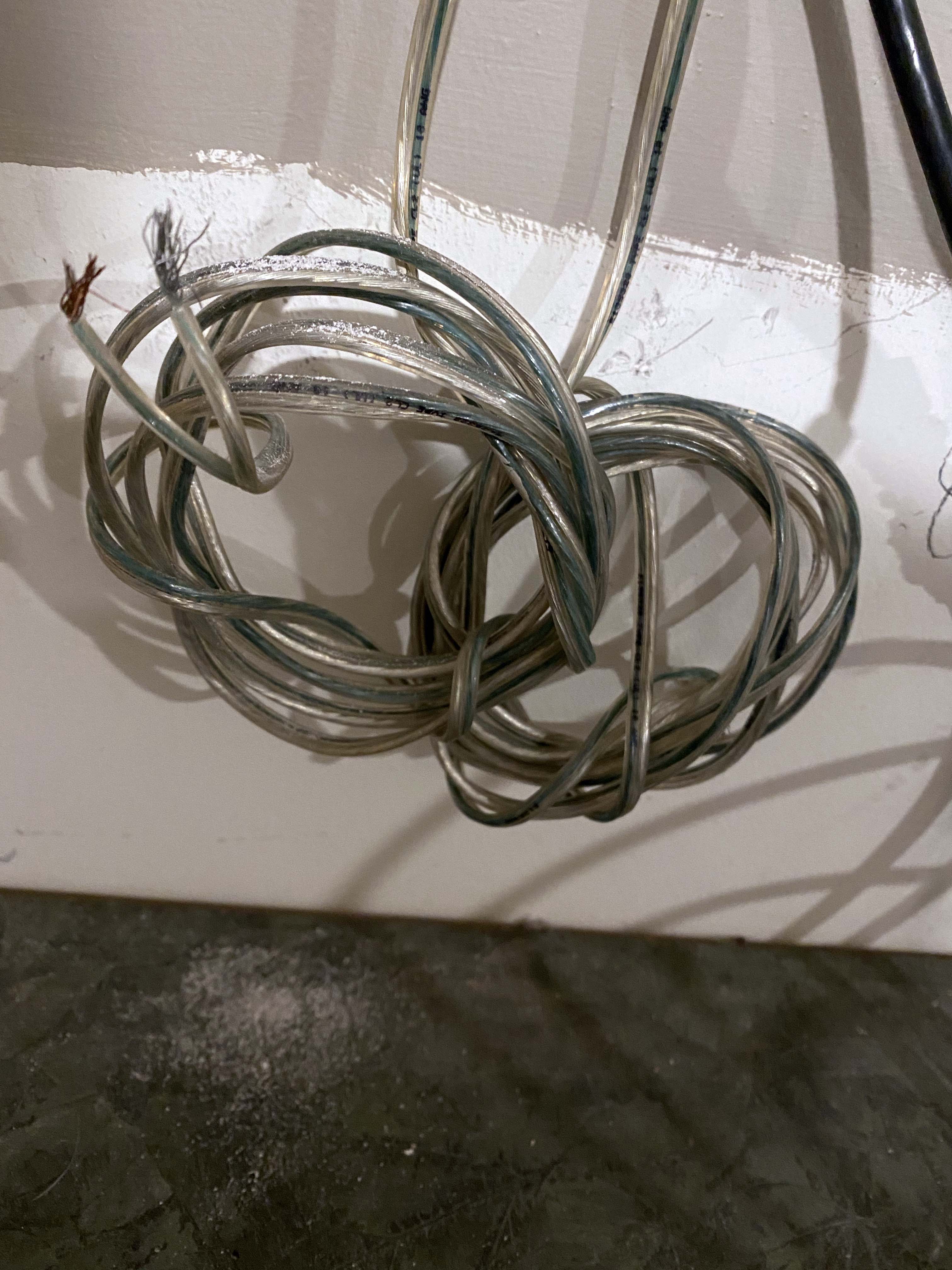

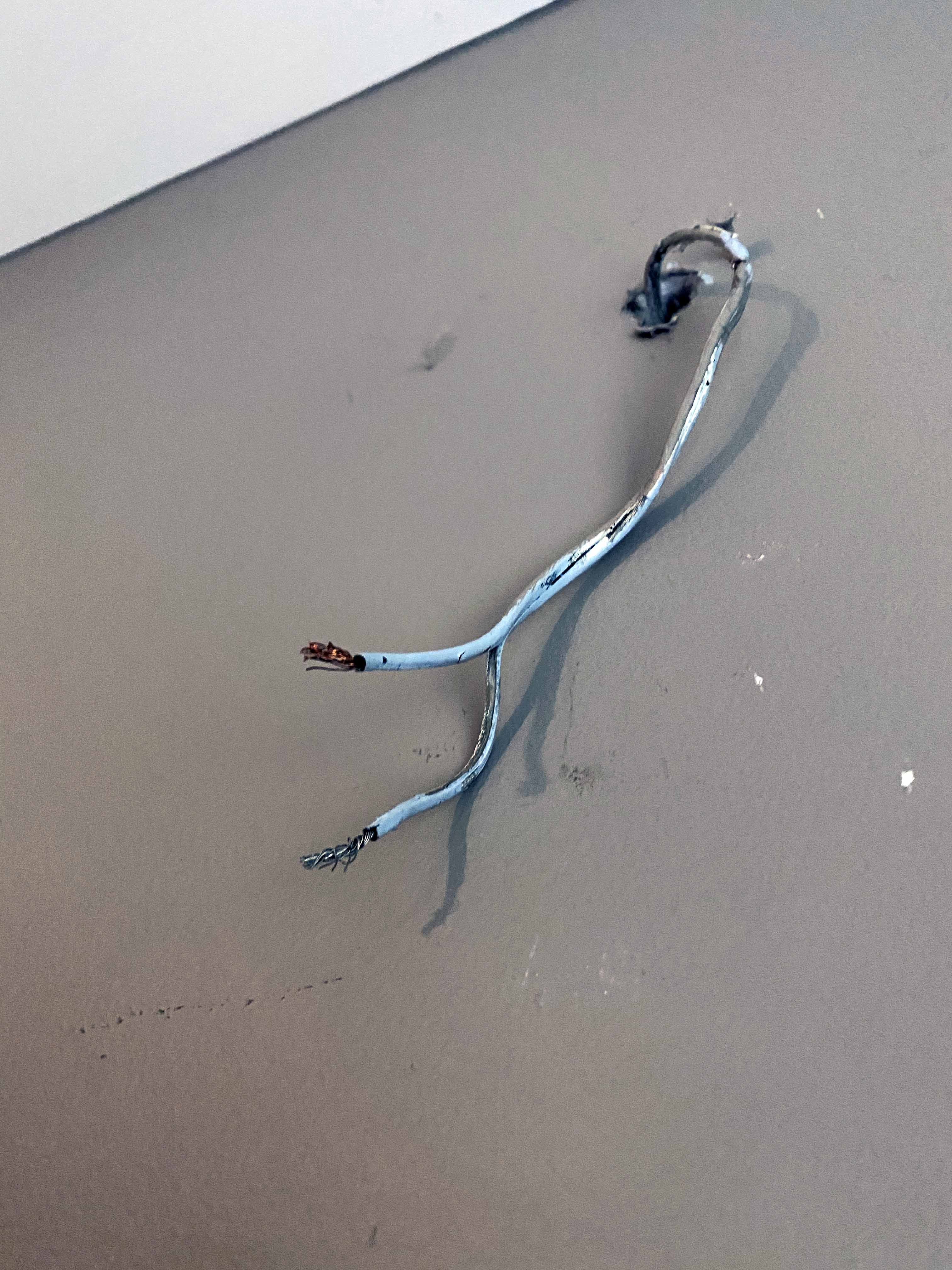

Also, the house I just bought has these existing wires for the rear L & R speakers. I can't tell the quality but from what the pictures show, should I keep them or replace them with the Blue Jeans Cable 12-Gauge? See pictures below.

That wire is a code violation because it's not allowed for in-wall or in-ceiling applications.
Don't worry about quad star or any of that stuff- just use 14 or 16 gauge cable that's CL-2 rated (CL3 if it passes though a cold air return)- it may be rated CM-R or CM-P if it doesn't show CL ratings.

The cable in the pictures is just cheap speaker wire it should work fine without issue. The only concern I would have is it doesn't look like it's in wall cable I could be wrong

You need a positive wire and a negative wire- that is all, even if the speakers have four binding posts (which is a marketing feature), you need two conductors to make the system work if the speakers have jumpers. If they don't have jumpers, you can make them. It will not only work, it will work well. I think Munster Cable is a huge waste of time in thinking about it and a big waste of money- they were one of the first shysters to trowel this stuff out there and if I could go back in time, I would try to prevent it from happening. I have been working in/with the audio equipment industry for over 45 years and have never known speaker wire to make a difference unless it was puny and couldn't handle the signal because it caused voltage drop. That's really the only thing to worry about.
Your twin lead wire is OK from the wire gauge standpoint and it would be fine if it was laying on the floor or on shelves, but technically, it doesn't meet Electrical code requirements. Aside from that, don't worry about speaker wire marketing BS, cost, fancy names or cosmetics, especially if it will be hidden.
