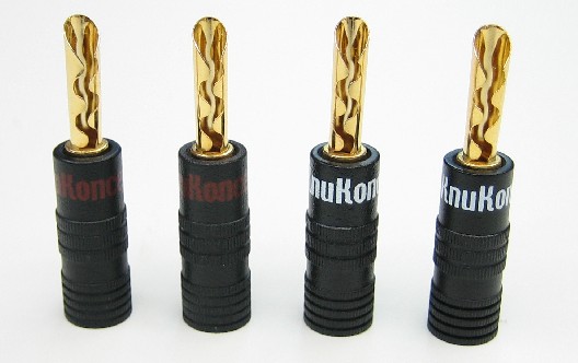

I use these now on my speakers because my speakers have some unusual split binding posts that caused my locking bananas to break:
http://www.knukonceptz.com/productDetail.cfm?prodID=eKs-BP
DS-21
I don't like any of the locking banana plugs, because they're all big, long, heavy, and uninsulated. While I've never done it personally, I've seen binding posts shear off AVR's because someone grabbed a banana plug with a long, heavy barrel the wrong way. I also prefer plastic barrels, because I want electrical connections to be insulated up to the actual contact point.
The bananas I use have a sawtooth spring like the Knu ones above, and just enough metal behind them to support dual set screws, in plastic barrels. They do have hideous Nakamichi branding, though. Not the best quality. The threads on the barrels are poorly done, and the set screws often jam if you try to unscrew them. But they're good enough, I guess, considering that at a $19.99 shipped from a U.S. source (an eBay seller) for a 24-pack I consider them disposable anyway.
Just an update. I recently tossed a handful of these into the trash.
One lost contact, and upon removing it, I notice that the barrels of several others were kinked.
Therefore, I do not recommend the "Nakamichi" sawtooth bananas. Even at a buck twenty-five a pop, I think they are poor value. Perhaps their conventional leaf-spring ones are more reliable, and sawtooth bananas are generally poor. I don't know.
I ended up replacing them with the "GE" compression-fit spade lugs that are $5/2pk at Home Depot; Irv Robinson recommended them in another post on this forum. They appear to be solid, high-quality pieces.
Spades do take more time to use than bananas, so I generally don't prefer them. But a secondary reason for my choosing spades here is because my current amp is very deep. Bananas stick out, and spades do not, so I saved some space behind the amp by switching to spades (as well as RCA cables with shorter-than-normal barrels).
