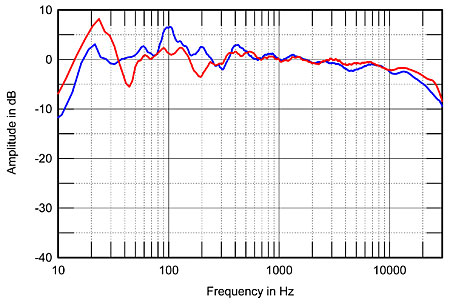

That's a bit strong. I've posted these in-room measurements before, but they're worth considering again:
KEF Q900's, prior to room correction, in Prof. Kal Rubinson's room:
Revel Ultima Studio2 in Dr. Fred Kaplan's room (red trace):
Revel Ultima Studio2 in John Atkinson's and Larry Greenhill's rooms:
(Do you know of other such published measurements, so I don't have to constantly repeat these?)
Note that the big, offensive swings are generally below 200Hz. (And as an aside, the speaker that is the exception, the Verity Audio Sarastro II in Dr. Kaplan's room, is a bipole in the offending region.) Which suggests that the only thing going cardoid or dipole is going to do is create placement headaches.
Those graphs do lend support to my position that too many people are throwing away upper-bass fidelity by crossing their subs over too low, and not overlapping them with their mains, though. And by using subwoofers that compromise on something very useful (upper-bass response) for something of debatable at best perceptual value (2d order distortion in very low frequencies)...
