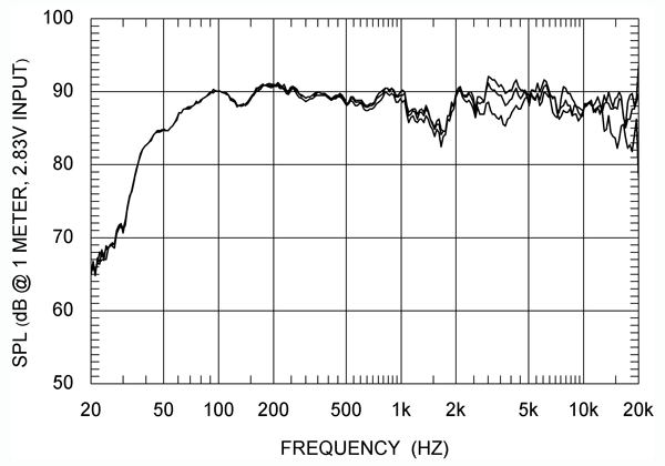

most Paradigm have excellent measurements. But........don't seem to enjoy their sound as much as the measurements would indicate.
I think for starters it's the crossover. I think the drivers don't "behave as one" even if they measure flat on the forward axis. Their websites state 3rd order crossovers, which furthers my suspicions. What you get is that "right up next to you" presentation instead of the "behind and beside the speakers" presentation. Some people love it.. but to me it's just not.. cool enough <_<;;;
I also think the non signature stuff doesn't seem to measure all that great at all. The monitor and studio lines seem to measure pretty boom n tizz, which sounds like paradigm to me.
I also suspect their boxes aren't tuned very well.
GranteedEV
GranteedEV
Paradigm Studio 10 v5 shows a lot of 2-8khz energy as well as a bit of a peak from 70-200hz.
Studio 60 v5 shows a big dip in the upper mids as well as some 3-6khz question marks. 90-300hz also look a bit elevated.

GranteedEV, for my own edification, can you explain to me what those graphs indicate and how they should be used? I would assume that, ideally, the SPL should remain fairly constant as frequency increases.
Just a frequency response graph. Tells you if the speaker is voiced to accurately reproduce sound, or voiced to sell speakers to the unassuming.
How to use them? Well don't waste your time with anything that reminds you of ski trips to the Rockie Mountains or horse saddles, etc. If both resolution and scale are not inadequate and it's flat as your budget can handle, then go and audition it.
Well there's two correct trains of thought:
1) SPL should remain constant given a specific voltage input, within 4db (+/- 2db) from 100hz to 10khz. Also try to understand the general trends.
2) Mostly the same, but with leeway for a slight reduction in SPL as frequency rises above 1khz, simply because some recordings are bright.
