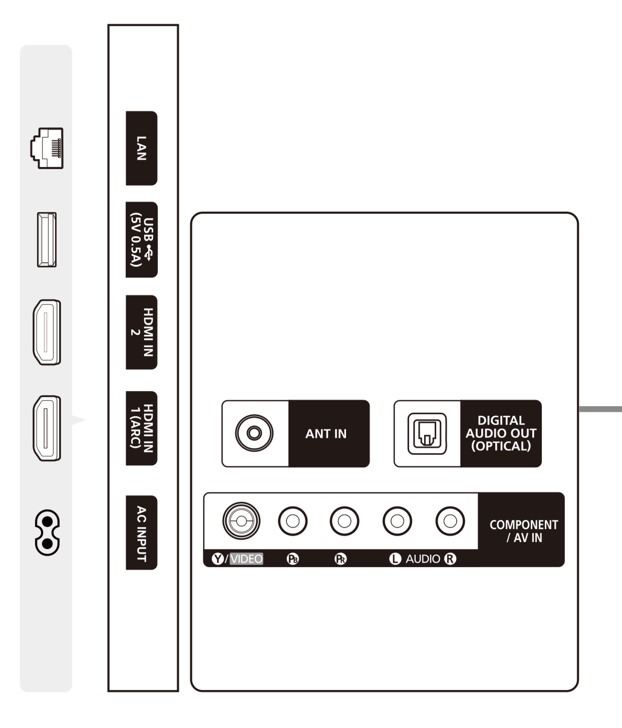

RCA to soundbar. Any ideas? TV sound is there but none to the soundbar. Only thing I can think of is the RCA cable is bad. (Note there is no HDMI option on this.)
Could be a setting in the TV to switch output to RCA.
RCA out on a TV ??
Been a long long time since Ive seen that.....optical pretty much replaced RCA out a long time ago.
I'll have to get an optical connection. No HDMI though.
Naxa/Samsung with a simple rca connection.

Samsung TV UN32N5300AF
Naxa 7008

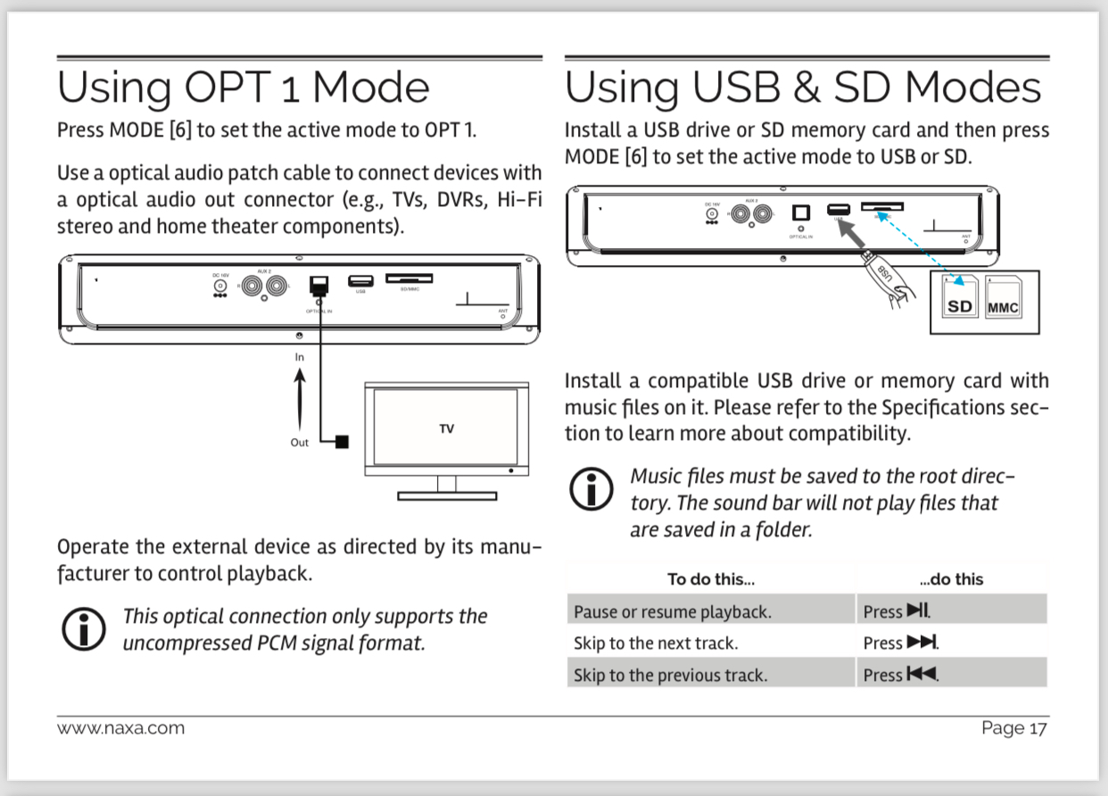

However, I have the Naxa manual and it just says plug in the RCA.

Page 17 of the Nixa manual.

I guess looking at that Naxa you either have the RCA connections to the aux 2 connection on the Naxa and in the source mode on the remote and chose aux2, or you have a opt 1 mode on the Naxa to your tv and it notes chose opt 1 from the source menu on the remote. Just a guess
The TV shows a Opt out and a Component RCA L & R. When all fails try another cable and connection point . The TV manual does note using opt out ( according to the quick set up pic)

The source mode can be done manually also with a button. I tried both that and the remote. I selected aux2 since that's what it said on the back of the tv and the naxa. In fact none of them worked when I toggled different modes. So it seems to me the RCA cable is faulty, or I need to go optical. There's also a USB to both the naxa and tv, but that seems like way inferior quality or is meant for a laptop. It's weird though cause if the tv has rca connections than why it wouldn't work I dunno.
The analog ports on the TV are INPUTS, not OUPUTS. The USB ports on both the TV and soundbar are INPUTS, not OUTPUTS and only accept storage devices.
The only option for an audio connection from this particular TV to this particular soundbar is the optical connection as the soundbar does not include the HDMI ARC port. The NAXA supports only PCM signals over optical so the TV must output PCM over optical.
Connect an optical cable. In the TV Settings, Go to Sound>Sound Output> Select Audio Out/Optical and Close. Then, go down to Sound Expert Settings>Digital Output Audio Format> Select PCM as it may be set at Dolby Digital by default.
That makes sense now. Only inputs. Everything else you said is correct too. PCM etc. Thanks much.
