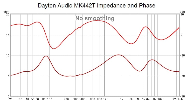

I wouldn't pay too close attention to base specs such as '4-ohm' or '8-ohm' and instead look at measured impedance charts, which tell the real story. What you want to look for is where the impedance curve dips the lowest and how steep the phase curve is at that point. That is far more relevant than some nominal ohm rating. Let's take a look at the MK442T impedance chart:
Here we see it does dip down to 5-ohms from 200 Hz to 300 Hz, which is actually a very heavily used band, but the phase angle isn't too severe. A budget AVR could run this speaker, but if you ran it loud for a long time, than maybe the low impedance of this range might catch up to the AVR and send it into auto-shutdown.
