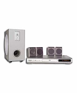

Mine is a BUSH DVDAVR12 dvd player with radio tuner and dolby digital AC-3 decoder, i bought it as a whole system with speakers and all. the speakers were connected to it and i still have it.

subwoofer:- output power-30W
impedance- 4 ohms
speakers:-system:1 way shielded
impedance - 4 to 16 ohms
speaker driverss: 3" full range

Dolphin - I asked if your original Bush DVD system had analog inputs because you could then use it as the amp for your sub. It looks like that unit has microphone inputs that we could use for this, but I haven't found any pictures of the back panel, so I don't know if it has a set of analog RCA-type inputs. You would connect the subwoofer output from your new Sony receiver to the analog inputs on the Bush, and connect the subwoofer to the Bush (like you did before you got the Sony receiver). The volume dial on the Bush would act just like the volume dial on a powered subwoofer.
Does that make sense? If you'll let us know what types of audio inputs that Bush system has, we could get you set up with this.

the bush has the following connections
speaker connections (RCA for all the speaker)
video outputs
component video output
2 audio input channels(L1,R1,L2,R2)
2 audio output channels(L1,R1,L2,R2)
coaxial and optical audio outputs
FM antenna connection
MW loop Antenna connections
Mains
Scart connections

Cool. Sounds like you can power that sub using the Bush, if you want to do that. It's the cheapest solution right now. Ultimately, you will probably want to upgrade your speakers and get a powered sub, but we'll cross that bridge later. :)
To do what I'm thinking, you'll do the following:
  1. Connect the Sony receiver's subwoofer output to one set of the analog inputs (e.g. L1,R1) on the Bush. You'll want an RCA y-splitter (either a cable or an adapter). Ideally it would have one male RCA plug on one end and two RCA plugs on the other, but I just haven't found one this morning (but I'm confident that they exist). You could use an adapter like this one here and connect that to a regular RCA patch cable like this one here. You can get those at a lot of stores, I believe.
  2. Connect the subwoofer to the Bush like it was before.
  3. Turn on the Bush unit.
  4. Select the input source on the Bush that corresponds to the analog inputs that you used.
  5. Initially, set the volume on the Bush to be low.
  6. Turn on the Sony receiver.
  7. Play the test tones and adjust the volume on the Bush unit until the sub volume sounds good to you.
When you use your system like this, you'll need to have the Bush unit on for the sub to work. The big picture here is that your Sony isn't powering the sub - it's just sending out a low-level audio signal for the sub that needs to be amplified. So, you need to amplify it to hear it. The Bush unit can do that for you (as could another amp, or a new powered subwoofer).
As a note, if the Bush system has settings for the speakers such as "large" or "small", you'd want to set them all to "small".
