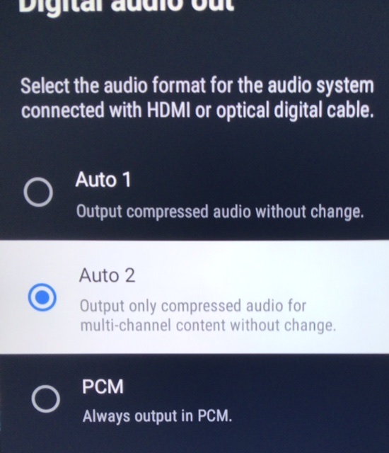

There is a digital audio out setting on the television. should I use the PCM setting?
Thanks TLS. I spent the weekend going through everything. I discovered an update on the television. I have the update set to notify me, but I never saw a notification. I installed the update and now the DTV genie is being identified by the Television.
Silly me, I think the processing is better.

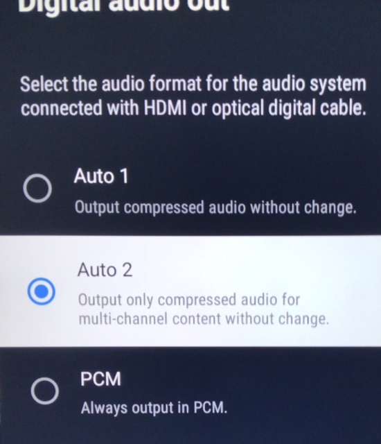

It seems as if you don't have a bitstream option, so it looks as if you have the correct option selected.
