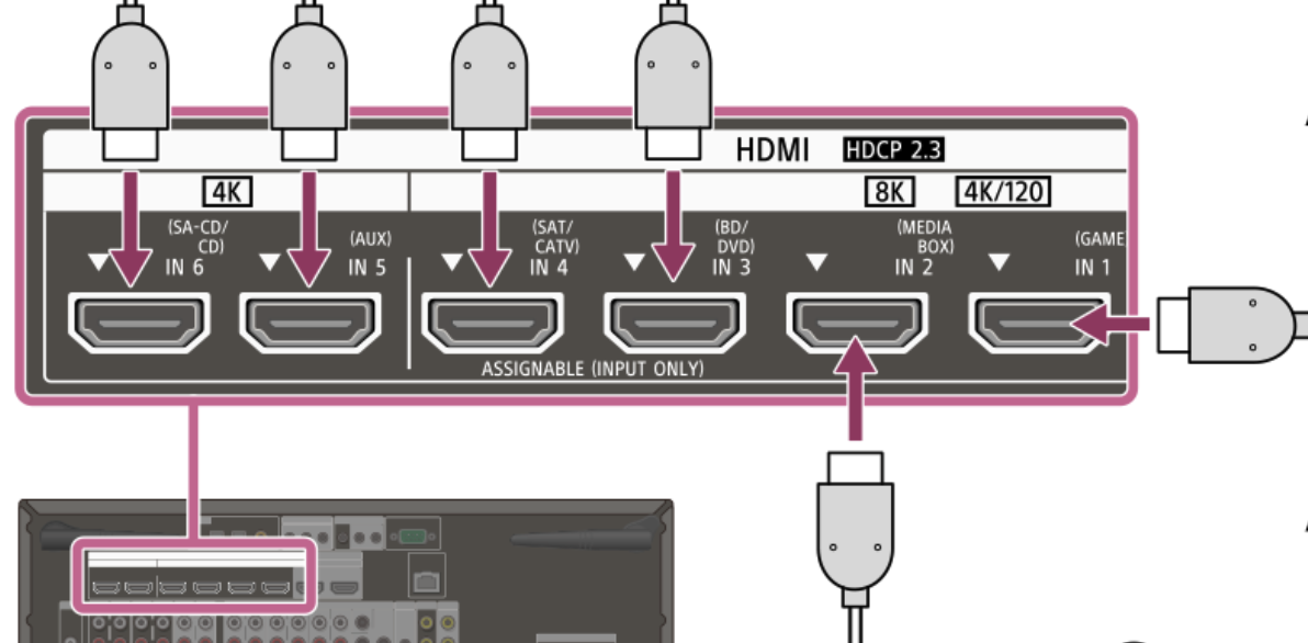

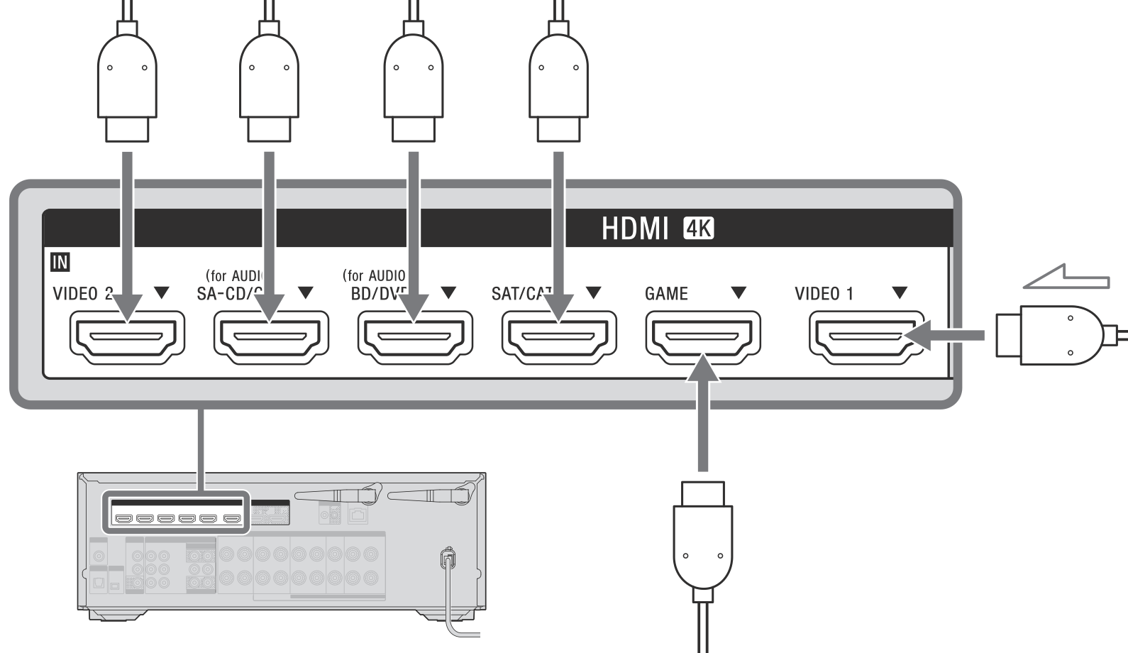

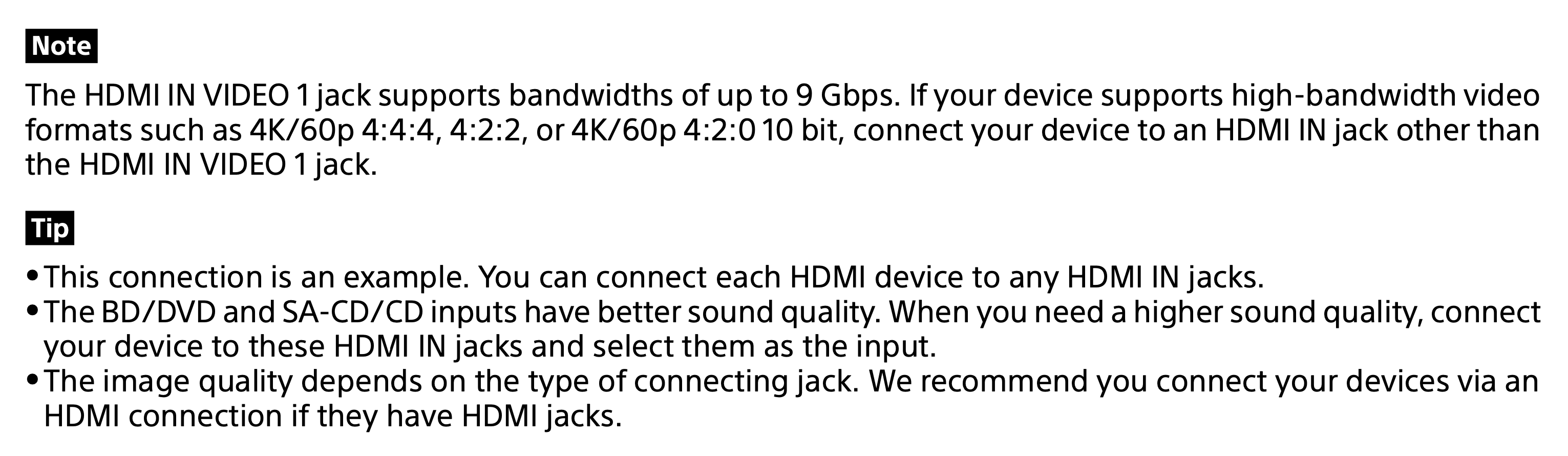

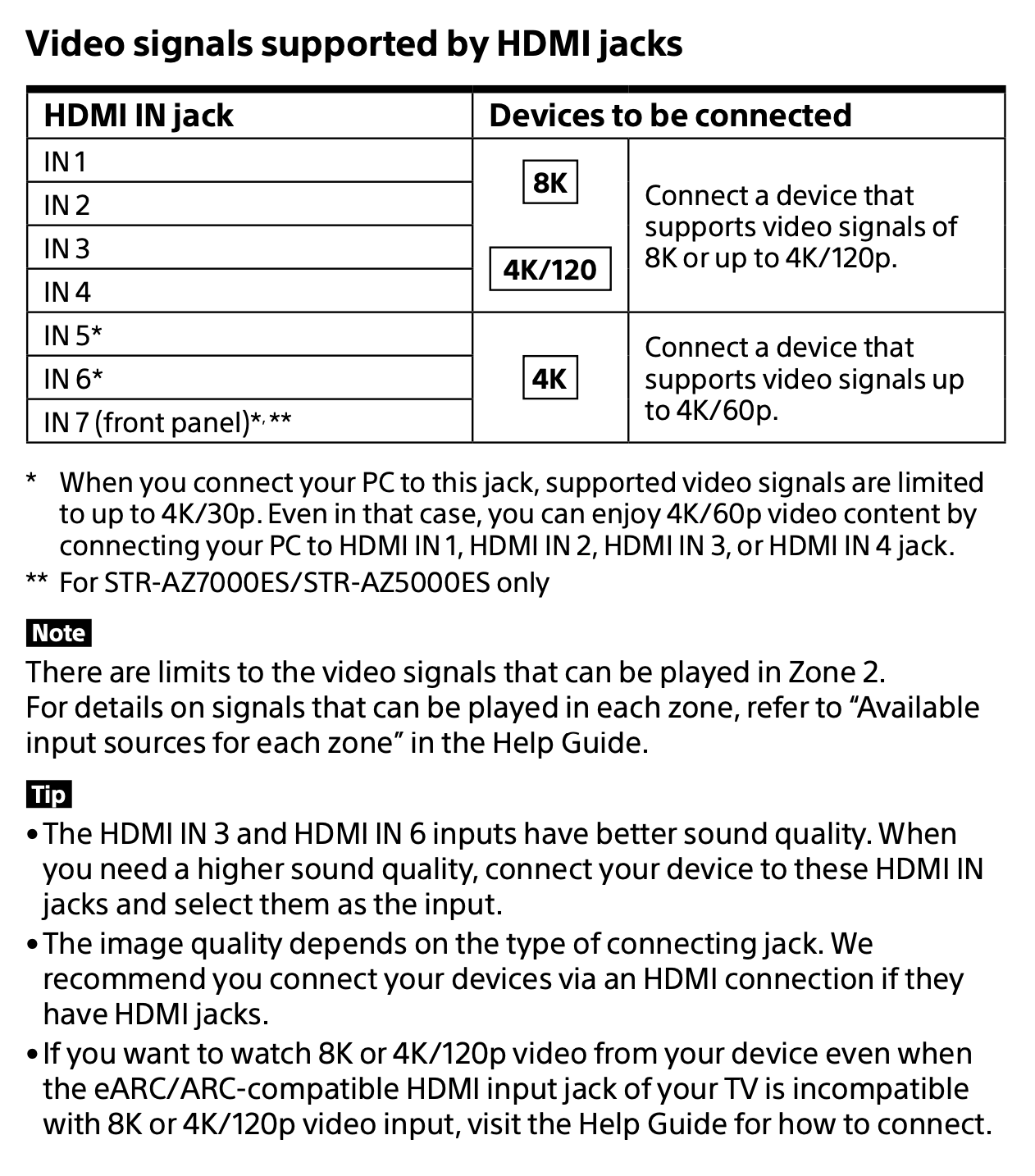

This one still confuses me. If I had to guess, it may have something to do with Native DSD but I'd just be guessing. Now, Sony has done this before concerning the now discontinued STR-DN1080. That receiver came out about five years ago and featured five HDMI input ports that supported 18Gbps and one port that was rate at 9Gbps. There was no 40Gbps HDMI 2.1 port available from anybody at the time. Now, Sony is offering four 40Gbps ports on their flagship models BUT now include not one, but TWO 9Gbps ports. They did not include two 24Gbps ports like some or even 18Gbps ports like some others still but decided to keep the 9Gbps port around and add another one to keep it company.
Now, if the BD/DVD and SACD/CD labeled ports do include some kind of Sony Secret Sound Sauce, then those using the new models will have to potentially make a hard choice. While the SACD/CD(#5) labeled HDMI port on the STR-DN1080 did support 18Gbps, the Sony Secret Sound Sauce SACD/CD(#6) HDMI port on the new models is a 9Gbps port. So, if somebody wants to enjoy 4K @120Hz or even just 4K 4:4:4 or 4:2:2 @60Hz video and savor the Sony Secret Sound Sauce at the same time, they have but a single HDMI port to use to do so by connecting to the BD/DVD(#3) HDMI port. The SACD/CD(#6) Sony Secret Sauce port on the new models is a 9Gbps port. So, a second device will benefit from supposedly enhanced audio while at the same time be crippled in the video department.
Sony STR-DN1080:
SONY STR-AZ7000ES:
I am also curious as to what difference in audio quality there would be on ports 3 and 6. I have 3 primary sources for content: cable box, NVidia Shield TV and Playstation for blue-rays. I want the best audio on all three components but have to sacrifice something for one? I can see that on the cheapest model where pennies matter but not on the top tier models.

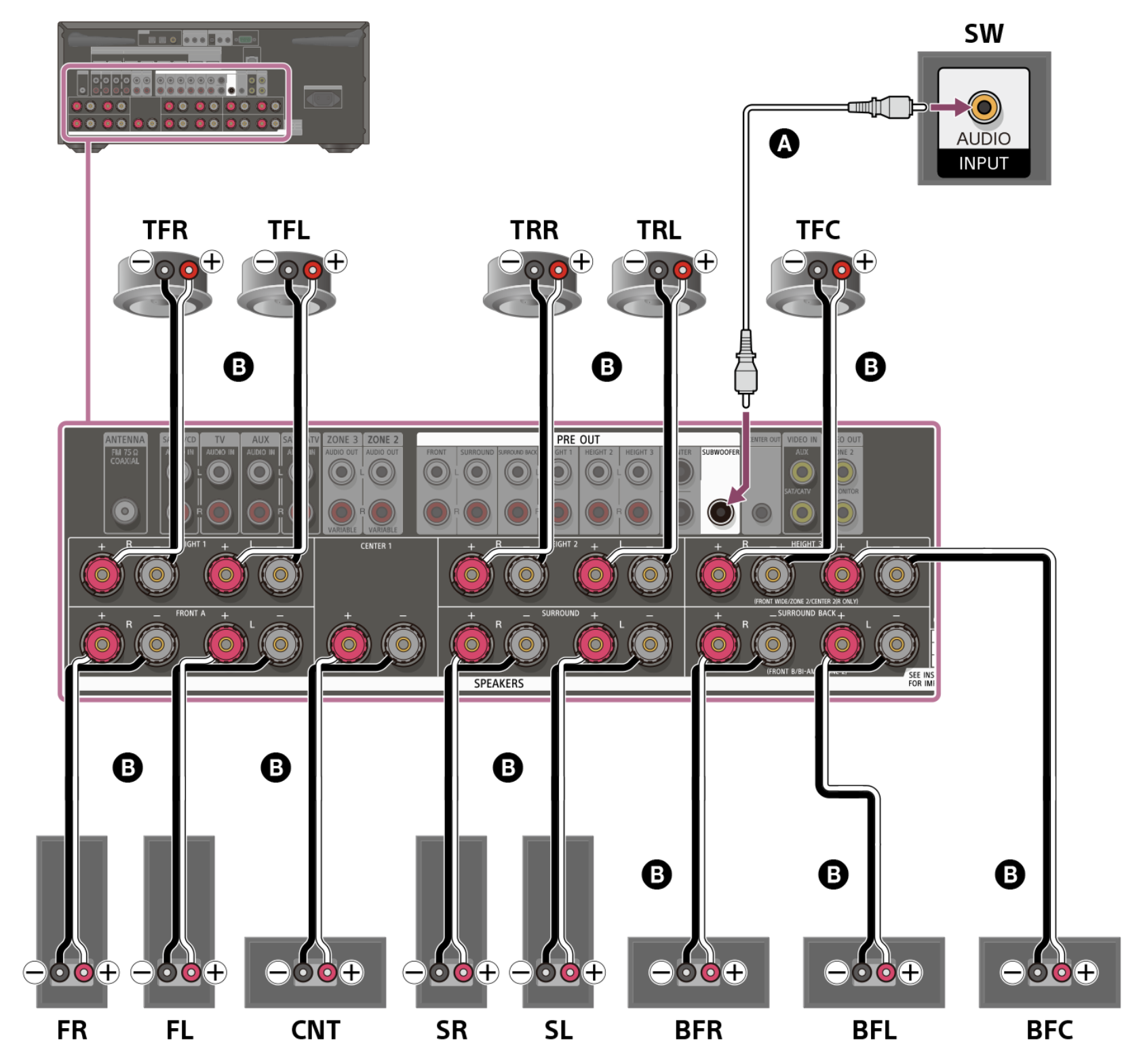

A single Center Speaker with a dialogue "Lift" feature can be found in one of the cheaper Yamaha receivers. I was surprised that it actually works and dialogue did seem to be raised up as if coming directly out of the middle of the screen when adjusted just so. Sony has some even more interesting options.

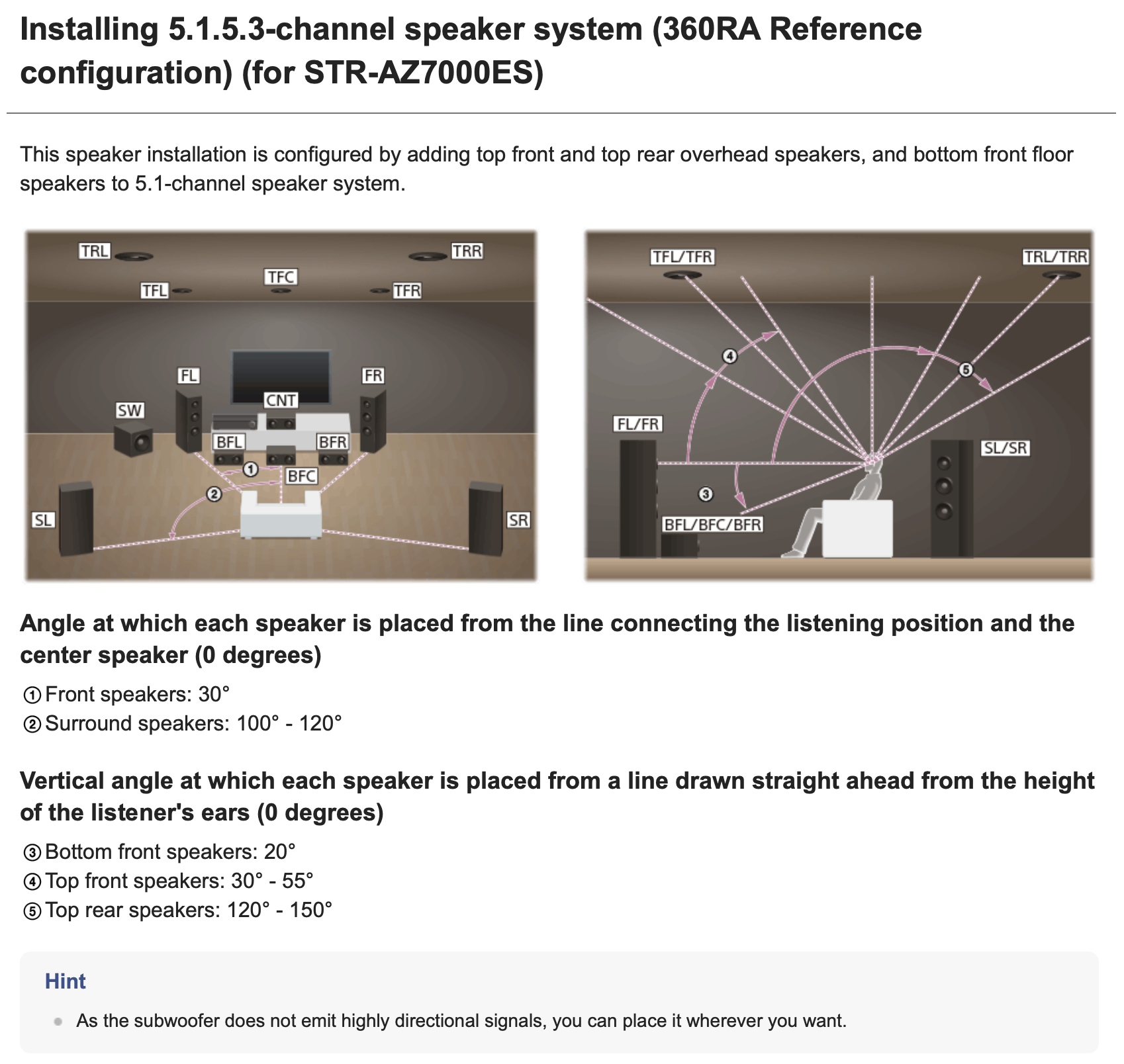

If you didn't like the idea of incorporating Auro-3D into your speaker configuration, you will love Sony's 360 Reality Audio setup. Ok, so I joked many posts ago in some another thread about Dolby adding bottom speakers in a future advancement on Dolby Atmos. Well, Sony beat them to it.:D
Trebdp83
Did you get the Hint by Sony in the pic? Stop stressing over sub placement. You can put it "wherever you want." It's been a long time since I've heard that one. ;)
Trebdp83
Really, no reactions to Sony adding another level and dot to speaker configurations? Finally, folks with three center channel speakers collecting dust in a corner can put them to work.:D
snakeeyes
Center lift, “Dialog Lift” on Yamaha only works if your heights are not being used for Atmos or DTSX, at least on the Yamahas I have from 2016. You choose one of the DSP Movie modes. (This is on a 2060)
Maybe by introducing a top center speaker on Sony, that allows the heights to be dedicated to Atmos and the upper center does the lifting with the lower center.

Interesting. You're very correct about Sony's claims about their 360 Spatial Sound but it's really unclear what their new Cinema Calibration does and doesn't do relative to Dirac, Audyssey and Trinnov. There is clearly major mainstream player movement right now in "spatial" audio, with Apple promoting it in their Homepod, Sonos' upcoming Era announcements, and the continued growth of Atmos enabled soundbars and speakers. Maybe Sony is jumping on that marketing train. Only a small number of people know about Bass Optimization and less about Dirac ART.
Sony does claim their Digital Cinema Auto Calibration IX "precisely corrects the distance, angle, sound pressure, and frequency response of each speaker... to create the ideal sound field for any home theater setup." I wouldn't expect Sony to compete with Dirac ART (that was why that preview article was surprising), but maybe their combination of DCAC IX and 360 offers a step up from standard Dirac. Unless they have come up with a way to optimize bass with one channel, I doubt they're close to Dirac Bass Management or MiniDSP MSO, but then Dirac Bass Management is only available on Arcam. Even if the Denon and Marantz chassis seem perfect for it this Spring, it somehow seems unlikely given the NADs all have independent sub-outs and they don't have Bass Management. Tuning the bass with Audyssey and the rest with Dirac seems cumbersome and less than ideal.
At the end of the day, I just need a 5.2.4 or 7.2.4 receiver and speaker installation that can do multi-room with TV or Airplay as source. I'd like it to be as spatially and bassially correct as possible. I have the benefit of an ideal room, specifically for symmetrical 2-sub front corner placement, so... I'm holding out for Matt's review of the Sony, because that could put me in a good-sounding, relatively bug-free, 7.2.4 receiver for $2100 (that I can still run SVS sub DSP or MSO w/ a MiniDSP). If DCAC IX and 360 are really just the same old not-as-good-as-Dirac room correction, then I'll just get a Pioneer LX305 5.2.4 with standard Dirac on the "cheap," and wait a few years to change out to a consumer-grade receiver with Dirac BM + ART.
Lastly, if I'm wrong about any of the above, I'd really like to know. It's really confusing to me exactly where standard Dirac and Dirac Bass Management lines overlap, and how one would ideally set up a Denon with Dirac + Audyssey for Bass Management without actually having Dirac Bass Management. Also unclear is if Denon Heos can play from Zone 2, because I don't want to integrate Denon with Sonos, two companies with a history of lawsuits. It seems nearly inexcusable for Sony to have just one bass channel in 2023, unless their engineers somehow don't see a need for it with DCAC IX/360. Maybe they're being bold like Apple, who doesn't have a line-in to their speaker. It certainly seems like the biggest miss, aside from all the HDMI stuff above.

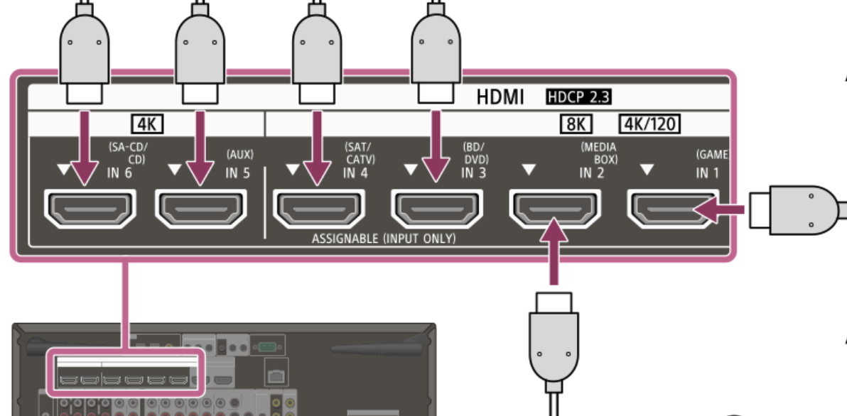

The HDMI limitations on these models is not just about game consoles. Any device needing HDMI 2.0 18Gbps capabilities will be out of luck if connected to HDMI ports #5 and #6. . So, connect a PC, PS5, XBOX Series X/S and an Oppo UDP-205 to the first four inputs and you are left with two 9Gbps ports that only support 4K @60Hz 4:2:0 8 bit. So, any new streaming device connected to these ports will NOT support anything over 4K @60Hz 4:2:0 8 bit.
Anyone connecting a streaming device to these ports will have output limitations. These limitations will potentially be made worse by services that do not support Atmos if HDR is not also in use. If the device cannot output HDR because the service does not support 24Hz output, then it will try to output 4K @60Hz 4:2:2 8 bit or 4K @60Hz 4:2:0 10 bit.Neither are supported and different devices will do different things to try and fit the signal into the pipe. PCs outputting RGB 4:4:4 @60Hz 8 bit will drop to 1080p @60Hz or drop to 4K @30Hz. Different streaming devices will do different things to output a signal given the limitation.
Those with a Denon X4700H or an Onkyo TX-RZ50 can see what this limitation means for their devices by connecting each of their devices to the HDMI ports on the FRONT of the those receivers. The Denon X4700H and Onkyo TX-RZ50 FRONT ports have the same limitations as the #5 and #6 ports on the BACK of the new Sony models.

You are not understanding that the #5 and #6 HDMI ports do not support 18Gbps which is very necessary for many reasons concerning new devices. It doesn't help that HDMI 2.0 has effectively been folded into HDMI 2.1 and manufacturers aren't saying anymore than they need to do so. 4K Enhanced(18Gbps) is necessary to avoid any SDR conversion, color subsampling and color bit drops that occur going through a 4K Standard(9 Gbps) port. You also don't understand that some streamers will NOT play 4K HDR @24Hz using certain services even if they have "Match Frame Rate" turned on as every service decides how their service will be supported from one device to another. So, a streamer will have to adjust output to accommodate the 60Hz only presentation of a given service's content . The Apple TV 4K doesn't support 24Hz playback without HDR in some apps and if there is an SDR conversion to fit within the bandwidth of a 4K Standard port the video will playback in 4K SDR @60Hz 4:2:0 8 bit. Many people watch 24fps content that is being output at 60Hz without even knowing it. Many don't have TVs that support eARC and will give up audio performance to deal with the limited video performance of the Sony ports if the other four are taken and they need to connect to the TV.
Ok, so forget Oppo. Say you only have Sony devices. You have a Sony A90J TV, PS5 and Sony UBP-X800 or X800M2 and use the TV's apps to stream from services. You want the Sony Secret Sound Sauce from HDMI ports #3 and #6 on your new STR-AZ7000ES for both devices. You will be forced to connect the PS5 to the #3 port to get 4K @120Hz. You will then connect the X800/X800M2 to the #6 port. It is a 4K Standard(9 Gbps) port. 4K HDR10 discs output at 24Hz and the Sony machines will output that video in 4K HDR10 @24Hz 4:4:4 12 bit automatically when connected to 4K Enhanced(18Gbps) ports set to 4K Enhanced Mode. But, when connected to a 4K Standard port, will have to do some color subsampling and bit drops to 4K HDR10 4:2:2 8 bit even with 24Hz output. There is a reason Dolby Vision discs have RGB 8 bit 4:4:4 @24Hz signals. Those are some ridiculous limitations and work arounds concerning very expensive Sony gear to sample Sony Secret Sound Sauce.
If there are any still confused by the issue, just know that a 4K HDMI 2.0 port may be a limited 4K Standard(9 Gbps) port or a 4K Enhanced(18 Gbps) port. You need 18Gbps to avoid issues with HDMI 2.0 devices that support 18 Gbps Sony should have labeled those two ports "4K Standard", not just "4K". If you are still rocking a 1080p setup including an Oppo BDP-93, a "fat" PS3 1st Gen and Pioneer Kuro plasma TV and just want a 5.1.5.3 Sony 360 Reality Audio speaker configuration, well, the Sony STR-AZ7000ES is the receiver for you and you should have no issues.
