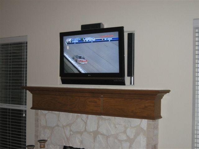

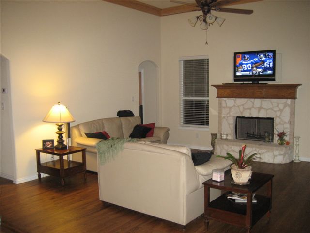

My son is walking. The floormounts need to go because he is pulling them down. They were cheap anyway so no big loss. My wife committed to getting me speakers for Christmas. So I want to go with:
1. Ideally In-Ceiling Speakers.
2. Am ok with Surface-mount Ceiling Speakers, if I can get them in white.
3. In-Wall speakers MAY work, but the two front speakers would be on different-facing walls so I don't think it is ideal.
I am concerned with sound quality of ceiling-mounted speakers in general, particularly 5.1 surround and directional sound. I play video games where directional sound is very key to play. Other than that I primarily will watch movies and it will be the main sound system for music.
This will be a 5.1 system .. I am not really interested in 6.1 or 7.1. I do need a subwoofer. I have a cheap one but want to replace it. I would like to keep it under $1000 for speakers/woofer, but that's not set in stone.
I am attaching a Pic. I am looking for all kinds of advice, and even interested in if someone could come in and do a professional install.

Why not go with regular bookshelf speakers on some good adjustable wall-mounts? Then when your rugrat stops knocking them over you can transition them to some nice stands.

Good Idea. Would they work ok mounted very high on the wall (near the ceiling) or on the ceiling? What would that do to the properties of directional sound in the room? Any suggestions on speakers?

Unless your son is very tall for his age, mounting them 4 or 5 feet up shouldn't be a big issue and there are plenty of speaker options you could consider, some which have the option for mounts (like my Axioms) or you can use generic mounts (some which require screwing in to the speakers and others which don't).
I can't imagine that ceiling mounted/flush mounted speakers would sound better. Every system using speakers mounted at or near the ceiling, or in-ceiling speakers has been very underwhelming to my ears.
I don't know what's the best choice for $1000 on the market these days, I have heard SVS came out with a speaker+sub package that might be in your price range and those are bookshelves which you can most likely wall-mount. I'm sure you can do Polk, Klipsch or Infinity for your budget but again I really haven't kept up with home theater for that price range and haven't a clue what the best choice would be. I would be of more help if you had maybe at least twice that budget (I don't, I just enjoy reading up on whats out there). AV123 has become popular, particularly the Onyx speakers so that is another possibility.
I'd suggest waiting on others to pop in with their opinions but in your case I'd go with what's recommend and put them on adjustable wallmounts, that way I'd think you'll be making the fewest compromises

Cool, thanks .. yeah that feedback is what I was looking for. I was not too sure on the ceiling speakers. I think bookshelf speakers mounted 5 feet up would work nicely.

I like the Axioms, but my listening area is 2601 Cu Ft. and open on one side. I am thinking they are too small.

Axioms - it says on the website that it is for < 2100 cu ft.
Ascend - Says for "most applications", while other of their speakers specifically say large or small with cu ft recommendations. The sub says for medium sized room.
SVS - have concerns about this as well, but I think with the upgraded sub I would be ok.
Onix X-CS - not concerned about these at all. Should I be?
