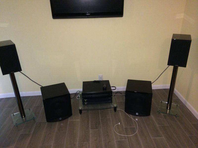

http://i998.photobucket.com/albums/af107/turbobike1/guestsuite_zpsc5f17ef3.jpg
I power mine with a pair of outlaw audio mono blocks, mine are crossed around 70hz to a pair of svs nsd subs, the entire system with amps, stands, parasound preamp, subs and speakers cost me around $2000!!! I have yet to hear anything as good for any where near that price...
My brother spent more than that buying a pair of imagine minis and rel subs that have nowhere near the output as this {although them minis sound really good too}... There are a lot of speakers out there, I like a music only system where you can test out and try anything you can plug into it for a little while, I have been getting rid of some gear here and there { have a few auctions on ebay ending today actually}, but the csb1's I don't think I will ever part with, they are my favorite speaker for $400, I like the epos on sale too, but the csb's are better to my ears, plus better finish, and with the audiophile terminals, magnetic grills, sloped front baffles, rite down to the embroidered velour covers they are a class act for sure... You put them with a pair of piano black sb2000's and you have one really nice 2.2 system...
