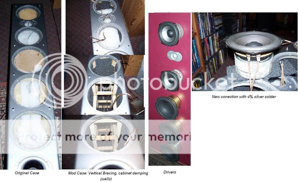

Hi. First I would like to start saying that I am not an expert, so I do not encourage any of this mods to anyone. I do it just for fun, I like to make little mods to my gear (personal touch) and in the process I spend some quality time with my dad. So, this is some mods I did to my RTi12. My Original plan was to use an active crossover instead of the passive one (thanks TLC guy for the information), so I decide to take out the crossover to see what components I need to remove, but to do so I have to disconnect the drivers (cables are to short so I couldn't remove only the crossover). So in the process I decide to do other mods: change the cables, added vertical bracing and some damping material. I take some pictures, I know many of us like to see what is "inside". I am still not very sure about the active crossover (because I do not have the means or knowledge to test the result, but maybe I do it some day just for fun (now I can access just the crossover with the new cables so it can be done easily), and give my impression. Another tweak maybe is to change the mids capacitors (and maybe bass capacitor too?) for a better ones (same value).Any recommendations are welcome.
I did one speaker at the time so I can compare them. The results: well all I can say is that the sound of the mod speaker is a little smoother, a little less “in your face” sound, (sorry no golden ears here). Pics:

The bass drivers are probably out of phase because their natural state has a phase shift from the other drivers used and in-phase resulted in a dip in response around the crossover point.
Damping material changes the size of the cabinet - the drivers "think" they are in a larger enclosure. You have to be careful about how much you add because you can overdamp them and that could hurt your midrage. If there was no damping material, I would imaging the amount added would help not hurt though. The bracing may help, but it depends on whether or not it was an issue before.
Changing out the wire should have had little or no effect aside from making them easier to remove, IMO. Changing the caps for the mids I am going to say will make a difference larger than the things that have already been done, though still not going to make a night and day difference.
Keep up the tweaking and let us know how it goes. Looks like a good project :)

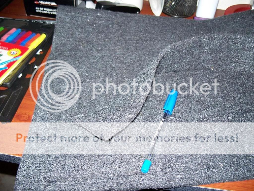

For the damping material I use something call "Pelero" in my country (Costa Rica). I use it because I have others speakers that have this material (2 speakers and a sub), is like a carpet material form of fibers of what appears to be cotton or some kind of cloth. Is 5 millimeters thick, I glue it to the walls, around 70 % of the internal walls of the woofers case, and around 90 % of the mid-tw case. What I like of this material is that is not very thick, and did not alter the airflow o between the speakers and the port.And then I reinsert around 80 % of the original damping material.(Polyfill?).
I also use this material to cover the walls of a klipsch subwoofer that have NO damping material with good results.(A little less boominess)
As for the smooth sound, yes I like how it sounds, but keep in mind that the change is small, so it is more like a tweak than a modification. The reason why I add bracing and damping was because after I removed the drivers and when I put my mouth inside the lower half of the cabinet and speak, I felt the vibrations in the side of the cabinet,(and I do not have a Luciano Pavarotti voice:)) and after I add the bracing and the damping material, I can not longer felt the vibration.
I do not have the knowledge to do a heavy modification like WmAx, so that's why I try to keep it simple, and like I said, , I was just for fun, and did not expecting a night/day . I fact my next tweak will be to fabricate a bass tramps for my room with mineral wood or rigid fiberglass and I expecting (hopping) a bigger difference that this speaker mod. I also think ( j garcia) that a better capacitors in the mids can make a difference, after all the initial idea was to change the crossover. Here is a closser look of the damping material:
