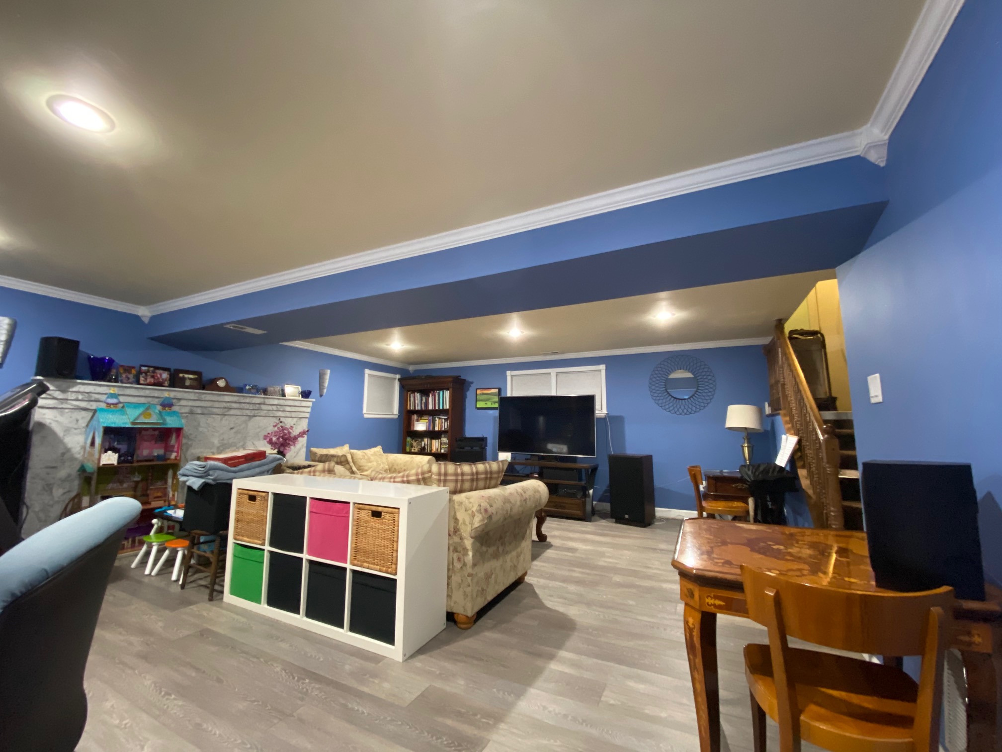

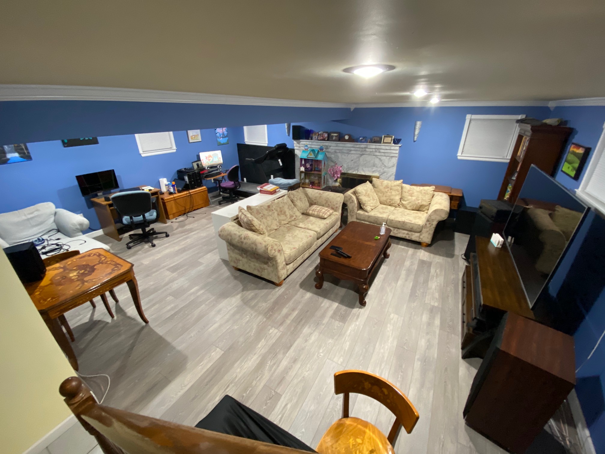

Here's where I'm at so far:
I realized that maybe part of my issue is how our room was set up. So, I rearranged the room today. The previous owner had speaker wire in the walls for the rear surrounds and I wanted to take advantage of that. Unfortunately, the wire was bad, really bad, goopy and green. So, I just ran new wire but it looks ugly for now. I also bought 2 speaker wall mounts for the rear surrounds. I have not installed them and the system sounds amazing except for these pops we get.
You can see the surrounds in this photo, one top of the fireplace mantle and the other on that table to the right.
The size of the room (18x22), pardon the mess at the back, I hadn't straightened the computer desks out yet

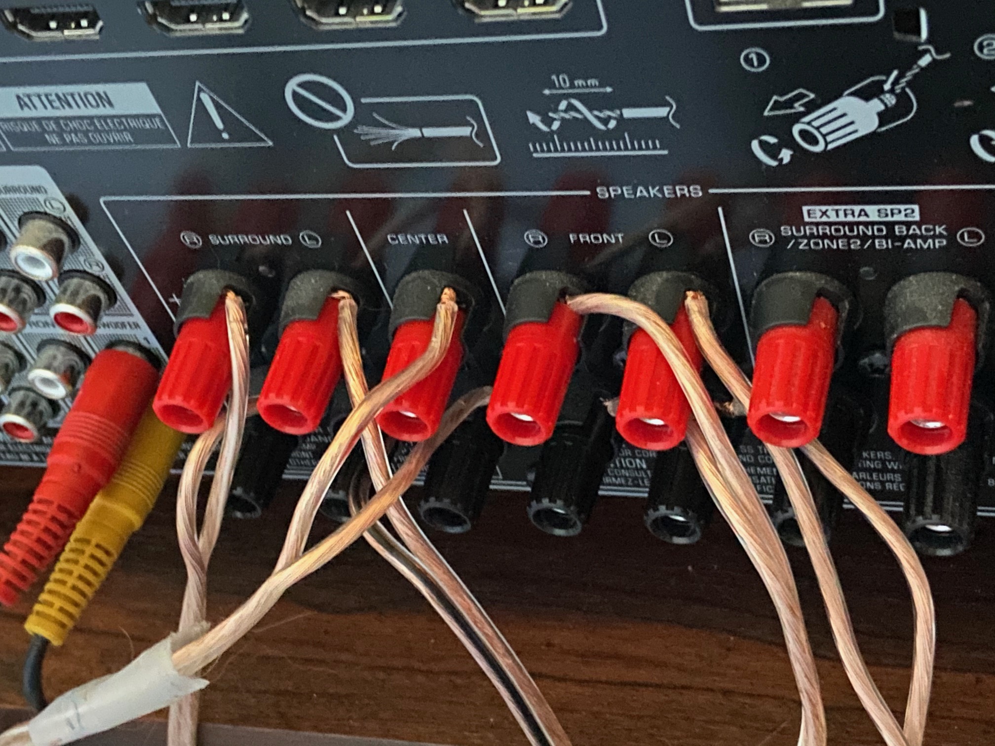

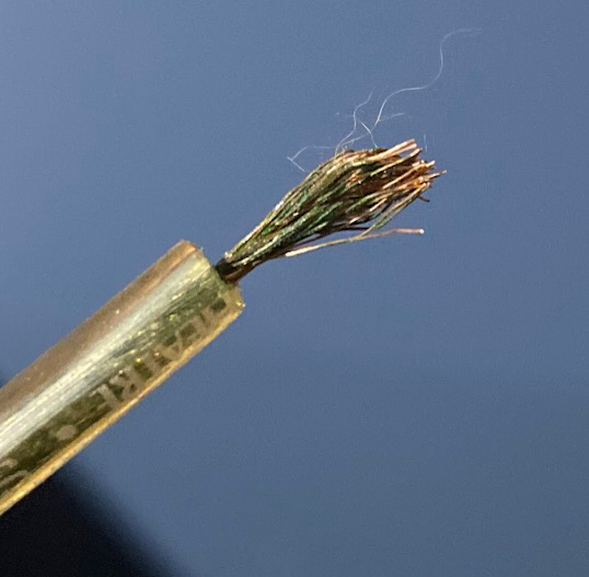

Added a photo of how I have the speaker wire connected to the AVR, just in case, but I don't think that's the issue with those pops, I think it's the speaker itself.
