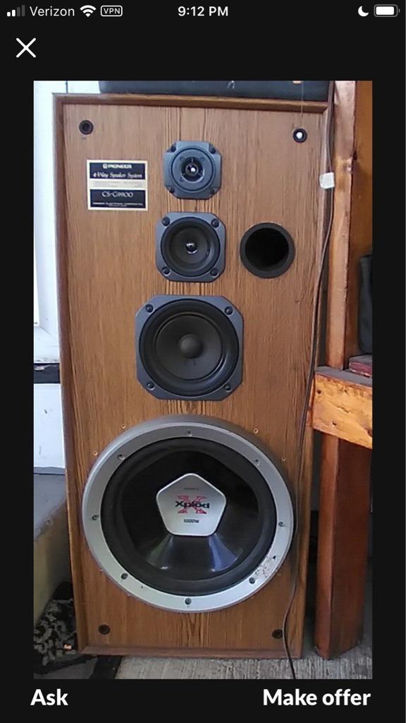

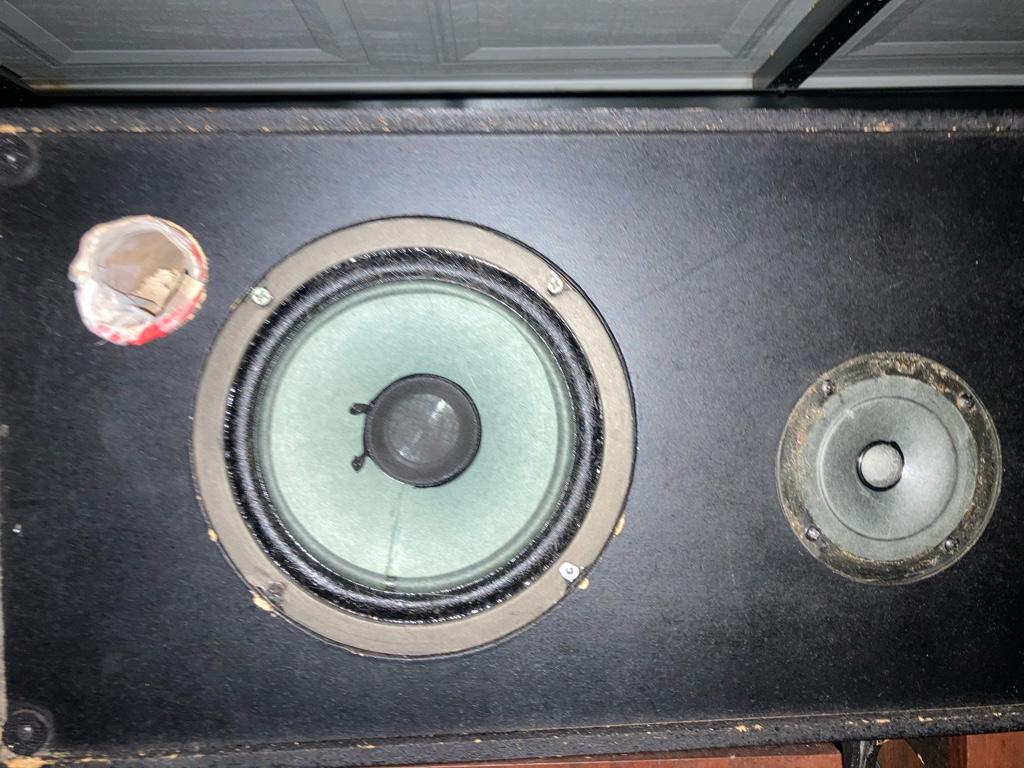

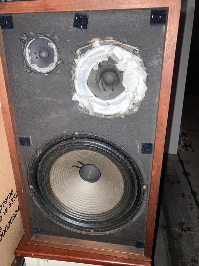

This one is dumbest I’ve seen instead of triple woofers it’s only got one .. and two faux drivers or radiators .. id never buy these polks
So I’ll never get a speaker as cheap as pioneers . pioneer sp-fs52 discontinued ...
that are as good wish ida kept my original pair I returned .... maybe they weren’t good enough speakers to keep making ? Or something
Makes me dislike pioneer audio
Oh ugly too
Rtr are good but ugly
The last pair is only useful as a coffee table ...
example of big woofer 12”
