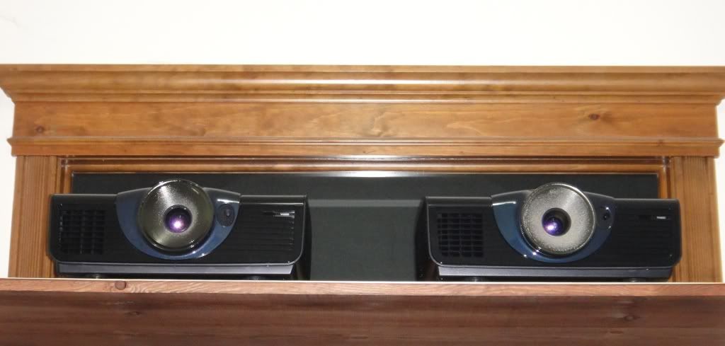

Would add the BenQ W6000.
Amazon.com: BenQ W6000 1080p DLP Projector: Electronics
I bought one over a year ago for $2200. Love it. Then now Amazon has it on sale. So I bought a second one.:eek:
