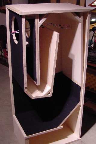

It fascinates me how the construction of the "port" (don't know the right term, transmission line?) can affect the sensitivity and dig so deep with smaller drivers. I'm becoming more and more interested in these designs.
The "port" in the speaker TLS Guy referred to is a folded horn. These horns are usually folded to fit inside a shorter cabinet. The horn throat (or pipe) gets wider as it gets further away from the driver. If I understand correctly, horns are used to enhance sensitivity of low bass response. Imagine an ear trumpet in reverse.
Transmission line speaker cabinets can look similar to horns, especially if they are folded. But they are straight or tapered pipes, where the wide end of the pipe is near the driver and the narrow end is at the cabinet opening. They work like tuned pipes in a pipe organ, where a column of air vibrates at a defined frequency that depends on the pipe length.
The SongTowers you heard are in a modified transmission line cabinet, called a mass loaded transmission line (MLTL). It uses a short wide port opening at the end of a straight pipe cabinet, which functions to let a shorter pipe length work as if its longer.
Yes, it is a horn. There are many musical horn instruments. The are the most efficient musical transformers. They match the high impedance throat to the low impedance mouth.
Before electric amps and speakers, the horns matched the diaphragm driven by a steel or fiber needle to the room. Many were quite loud with no amplification.
And like this.
Paul Voight produced a paper coned driver with an enormous electromagnet and horn loaded it. That was the Voight corner horn.
That was in the thirties, and widely recognized as the worlds first high fidelity speaker. This was the birth of Lowther, which are still going strong and not owned by any venture vultures. They are easily the worlds oldest high fidelity speaker manufacturer.
The principle is low Q drivers, with very high flux density. This makes for very efficient and sensitive speakers, but bass deficient, so a horn is required to keep everything in balance.
