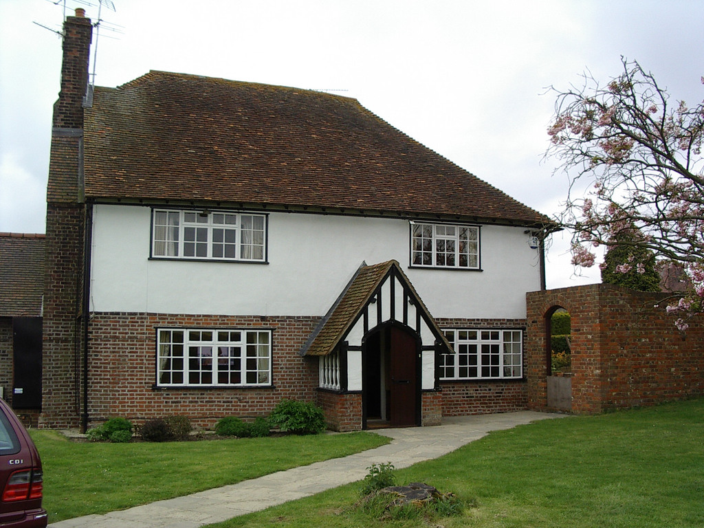

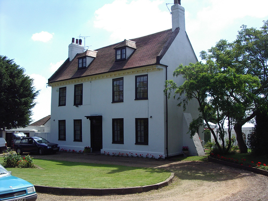

In Europe and I suspect a good deal of Asia, rooms are small.
In the UK there are tons of historic buildings. I have just finished a trip to the UK with four full days in Paris. We went with some very close friends who had never been to Europe.
After a day or two, Ralph said, "I knew there would be some quaint stuff, but I did not know the whole damn place was quaint!"
In six of my close relatives house your would be up against open beams and ships keels several hundred years old. So the cabling is a nightmare.
Then fitting even a smallish 16.1 aspect TV is a problem for many rooms. A small set of speakers and a sub in many cases maxes it out. Five or seven speaker is unthinkable.
Then you have the problem that a huge number of house are terraced or semi detached. If you bother your neighbors and get turned in, ALL your gear is confiscated at the second complaint. So no sub woofers or low powered ones are the order of the day.
To be fair there is a wider choice of 2 and 2.1 receivers in Europe than here, but not as many as their should be. I think there are plenty of situations like this in the US if you look.
The other issue is the size of the receivers. This has always made separates popular in the UK as amps can be placed out of sight.
So this one huge size fits all is bad business and actually poor marketing.
