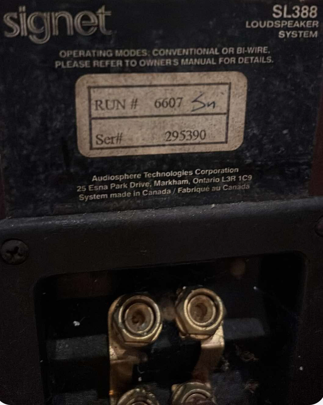

I have the option to buy a pair of these 388's for $39 - but now I'm kinda worried that they're either not going to sound good or the 4 ohms thing will be a problem.
But for $39, will be fun to play with
