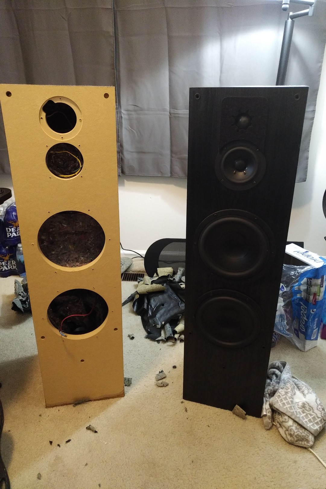

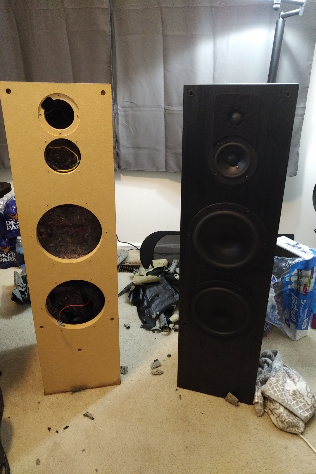

Caution be damned... we're going to try and refinish these things. So I took out the tweeter. Had to carefully chisel off the "Sonofelt" first.
Hey it's not made in China! Turns out it was made by Seas.
Some more digging and it seems that Signet used Vifa (now Peerless) woofers. I'm guessing that since the midrange has the same cast frame and similar part number it was also made by Vifa.

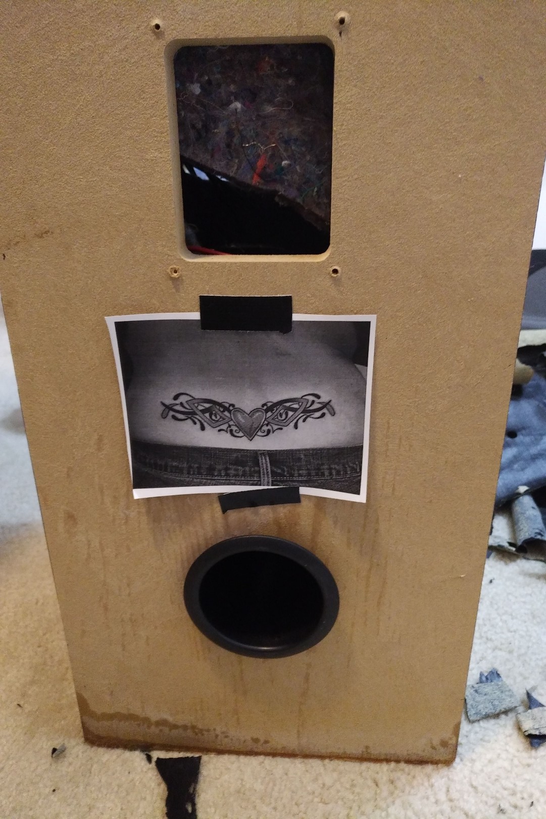

WARNING: PORNOGRAPHIC IMAGES AHEAD
Let's get naked girl! Take it all off!
Let me see that boo-tay!
Oh snap- you's a freak!
Whoa- you brought a friend? Looks like we're gonna party tonight!

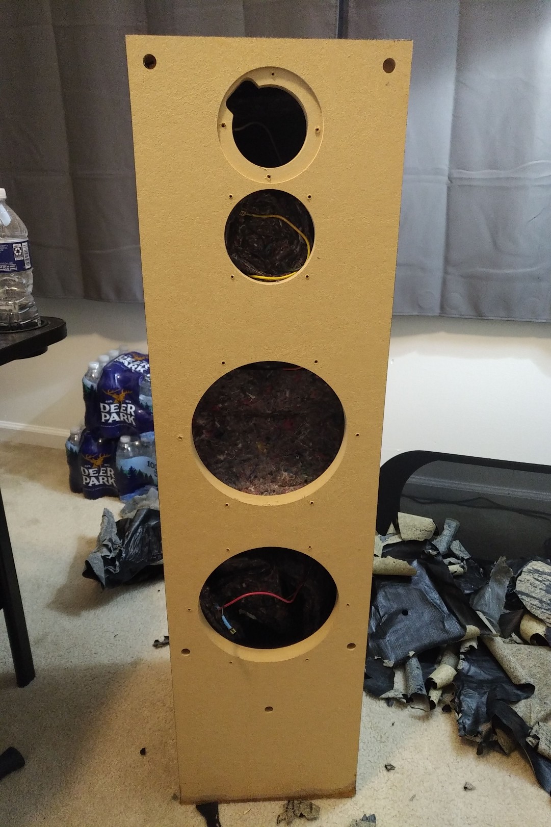

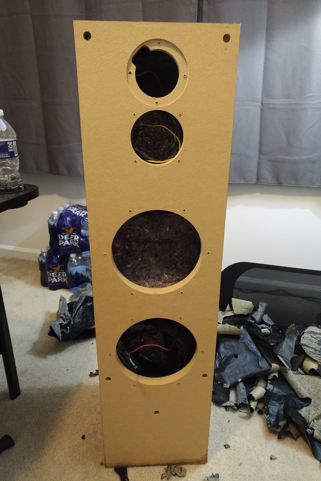

Stripped, sanded, ready for action!
The Bondo job I did on the damaged corner came out pretty good. Not perfect, but I'm happy with it...
Welp, all the "easy" stuff is done. Next will come the part I'm most scared of, once the veneer is nice and flat.

They're already good cabinets. That hideous black vinyl wrap just had to go.
The cabinets are lined pretty thoroughly, except for the slanted plane behind the upper woofer. To be more specific, one speaker had the lining and one didn't. The glue is there but the cloth was missing. Guess I'm not the first set of prying eyes...

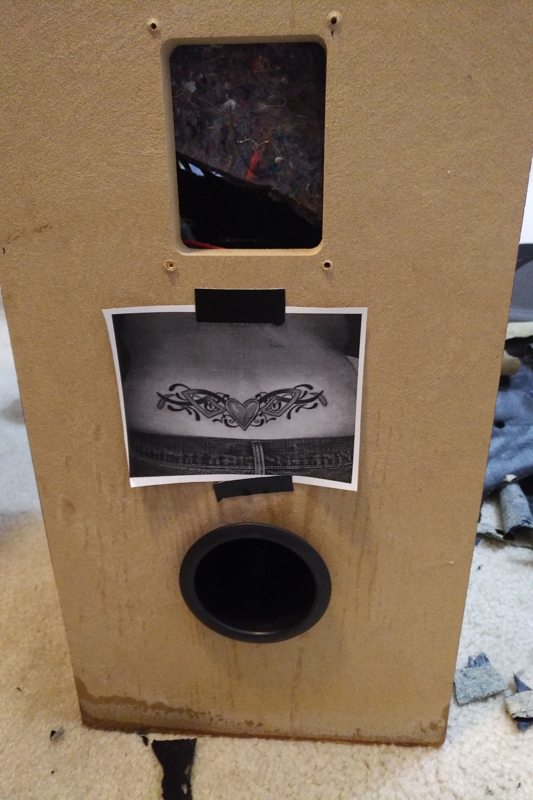

LMAO!! lolo i just noticed the pic on one of the boxes. I’ve looked over your thread at least 5 times never noticed the pic with Tattoo lolo. Best post of audio porn to date! 100 more points on your man card!! lolo
