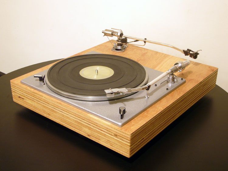

I now remember I once saw, at an audio show (where else?), a turntable with two tonearms. (See an example in the photo below.) I'd never seen such a thing before. I asked, why two tone arms? It was in a room run by a very serious dealer from NYC who aimed for audiophile customers with more money than sense. This dealer also displayed very large German-made speakers with horn loaded tweeters (they sounded dreadful) driven by flea powered (3.5 watt) SET tube amps. He bristled at my two tonearm question, so I avoided any further conversation with him.
I now see that two tonearms on one turntable could be used to compare two different pickup cartridges. It would avoid the remounting difficulties. Any preamp requirements, if comparing a MM pickup to a low output MC pickup, would be a separate matter.

That turntable is a Goldring Lenco and sixties vintage likely.
Those turntables are an idler driven turntable, but the motor pulley is conical. The speed is varies by the speed control sliding the idler wheel up and down the conical Spindle/pulley.
So this turntable has a wide adjustable speed range. They are highly sort after by 78 rpm enthusiasts because of this feature. There was a lot of speed variation on the 78 rpm era, as that was only a suggestion and different firms had different speed standards. With the old spring wind up turntables and the early electric turntable had a gimbal governor like on an old steam engine, and the speed control pulled in or let out the fly weights.
The arms on that turntable are the Lemco arm, the other is the 12" version of the SME series II improved arm.
So this turntable could have had, and probably did have multiple functions. It would be capable of pro 78 disc archiving and the SME arm would have allowed the playing of over sized WW II vinyl 78 rpm disc that were used by the allied forces and are a hot collector item.
Those turntables fetch serious money.
That photo was meant only as an example of a turntable with two tonearms. I chose it only because it clearly showed both tonearms. I did not recognize the specific turntable I saw at that audio show. Nor did I ask. I should have been more clear about that.
