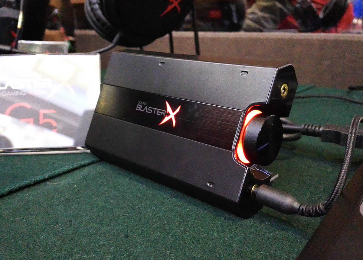

UPDATE: I bought a headphone amp and the bass no longer distorts on that frequency sweep.
My headphones also can now go loud enough to use SonarWorks Systemwide as an added bonus!
You got results because you followed advice.
http://uk.creative.com/p/sound-blaster/sound-blasterx-g5
All DSP and snake oilery disabled. $110 off Amazon.
And then calibrated to flat with SonarWorks Systemwide:
http://www.sonarworks.com/systemwide
I see that amp has a switch for headphones of 32 to 150 ohm and for 150 to 600 ohm. I don't think I have seen that before, but it is something all headphone amps should have.
The output impedance is a very low 2.2 ohms. So I'm not surprised it solved your problem.
