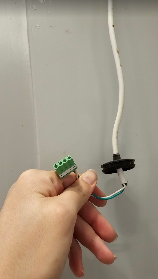

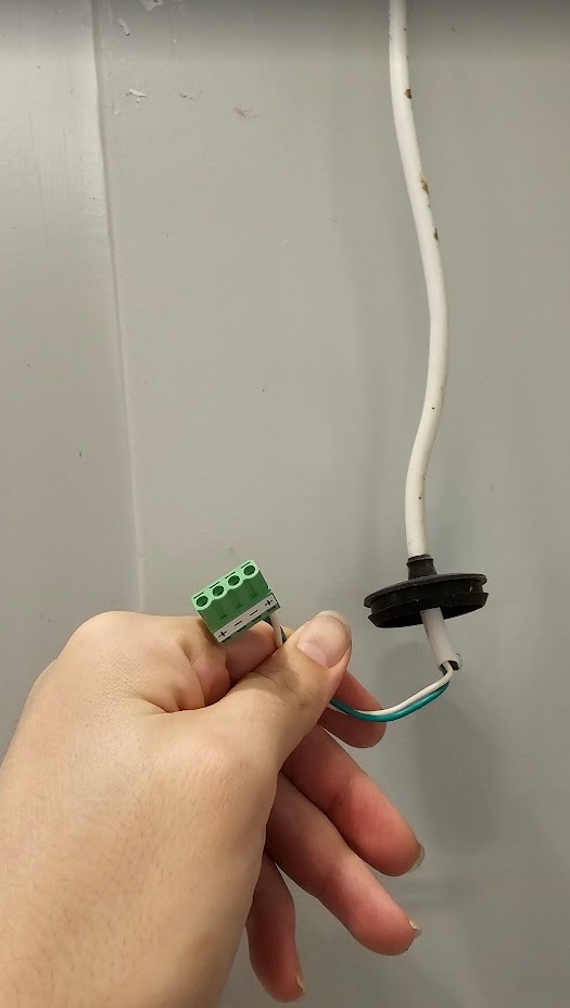

Folks, I recently moved into a house. Garage had a set up four speakers. Previous people have taken them all, leaving only the cables dangling off the wall. (You can see in one of the pictures with a green arrow how they used to look like before they took them out).

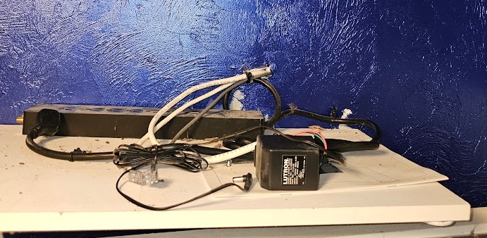

I located where the cables lead to. (Also in the pictures). However, that cable has only 4 wires (black/red/green/white), while there are four speakers, three of which have red/black combo and one of which has green/white.

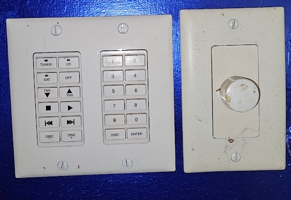

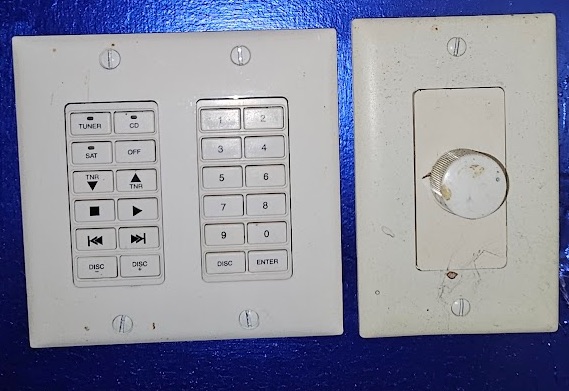

4 -- There's a control keypad on the wall. Is this something I should try to bring back to life? How helpful do you find such wall-mounted controls?

There are four speaker cables, but wires enough for only two speakers -- black/red/green/white. How would those work? Do you think such a setup exists a black/red wire can power multiple speakers, rather than a single designated speaker?

So there are four wires in one jacket? Installers could have pulled one set of 4 for two speakers and separated the other two out.

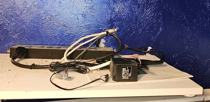

You need to show what's on the other end of the wires, especially the ones feeding the keypads in order for anyone to advise on whether you should try to use them. They don't just work on their own- the fact that the one keypad has source buttons proves it. Remove the volume control and the keypads to find the brand.
magtymguly

Since you don't have the speakers nor an amp for them, I'd bypass what setup was there altogether (sounds like you have no particular use for it). Another Wiim amp sounds like a good way to go with a new pair of speakers. What kind of budget for amp/speakers for the garage?
