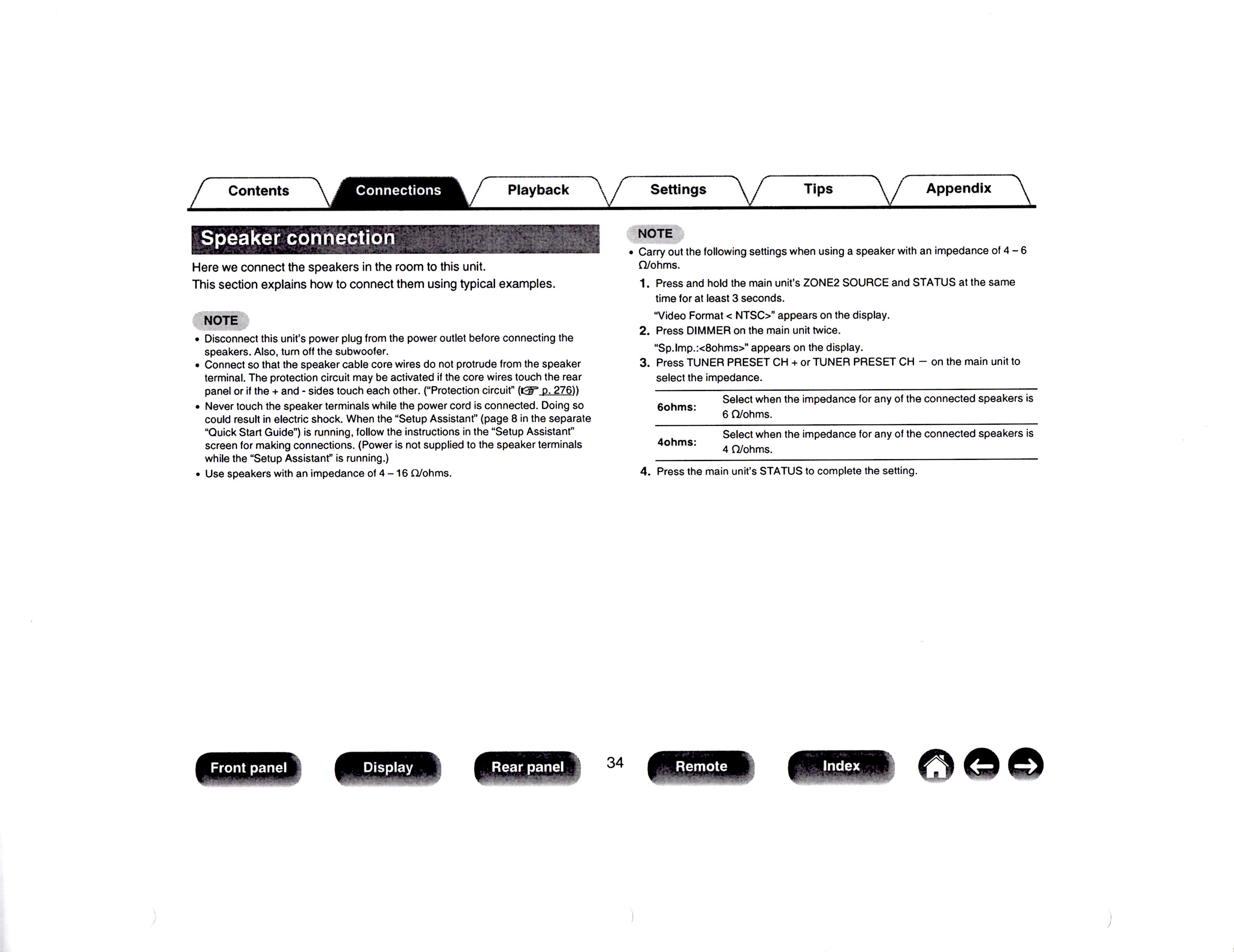

Here is page 34 of the Owner's Manual for the SR5010:
The text is a little small but indicates settings for 6 ohms and 4 ohms separately.
Why not choose the 4 Ohm setting found in their manual?
