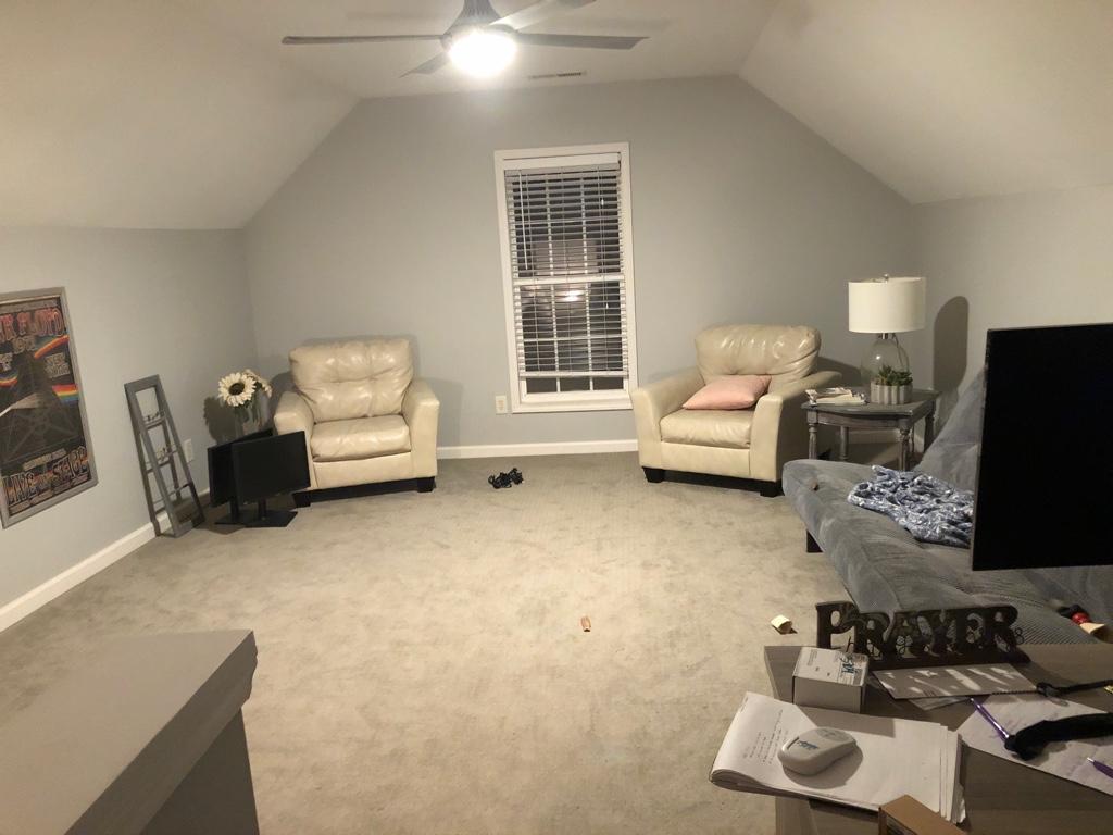

Yeah, your desk being in a corner on the opposite side of the room isn't really all that ideal. I saw boat also suggested going with a desktop system. I might lean that direction too unless you have some flexibility with placement.
I snagged your pic so the others can see what you're working with.
If you could slide the desk out of the corner and more in the middle, and place your speakers so that you make an equilateral triangle that would be very close to ideal. Even if you end up with killer speakers, poor placement can lead to not a great experience.
PS, just saw you posted images. Very helpful!
The stairs prevent centering the desk

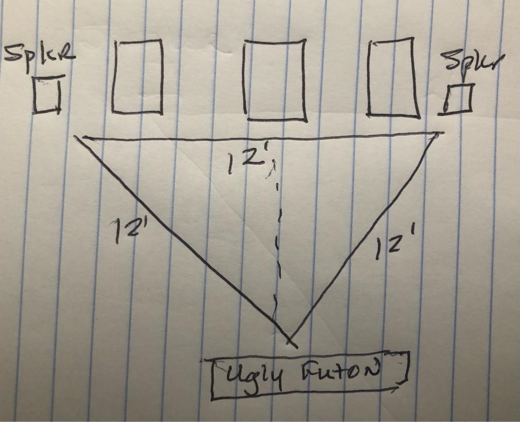

To allow better triangulation, I can set up a system on “Pink Floyd - The Wall” (formally known as wall with Pink Floyd posters). I took this photo from the “ugly futon”. I am 12’ from the Pink Floyd wall. If I have a speaker on outside of each left and right poster, the distance between speakers is also 12’
Essentially it’s an equilateral triangle of speaker - speaker - middle of ugly futon
Does this make options better?? Simply now have an office that will couple as an audio room
