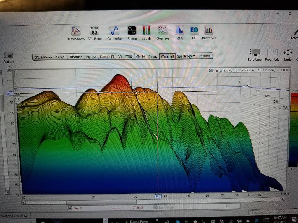

So since you all have been very helpful and i know i started this on sealing doors....but i have a question since we were talking making the room better. This morning i took a sweep from 10 to 6000 hz. I wanted to drop some pics for you to analyze. From my limited knowledge on waterfalls im thinking it doesnt look good.

FWIW there’s a “camera” button on most of the rew screens. That acts as a screen capture so you can just upload actual screen images without taking pictures. Also, that dip at 18hz looks like it’s caused by a phase switch/knob setting. Try switching one to 180°. Possible a port interaction.

Ill switch one of the phases and see where that goes. Just so its noted there is no smoothing. I noticed with smoothing of 1/6 the graph looked to nice. Didnt show where the problems where. I also for one sweep i moved the mains closer together. There was no change in response until say the 150 mark but the soundstage felt very narrow. Almost uncomfortable

Yes. Sweep with only LR plus subs. You can also do individual subs and then combined to see how each effects the others. Also, some people sweep with center plus subs to avoid possible comb filtering from the mains producing the exact same signal.

Well i did sweeps from 10 to 150. I have that dip at 18 or so still. Move each one at a time oop, then all oop then each one going back to 0. No change in the dip. I moved my rear sub back a little which improved it a bit but as i kept going back it started to negatively effect it again. I will say i had to go into the furnace room a few times as i keep all my cables and audio acces. in there and forgot a few times to shut the door. Right off the bat thru rew i was like ok forgot to shut it. It was a neg effect. Im honestly wondering if the 7 ft ceiling is making that dip. I know taller is better and i have to work with it but it is taking so much dbl out all the way to say 25 hz
