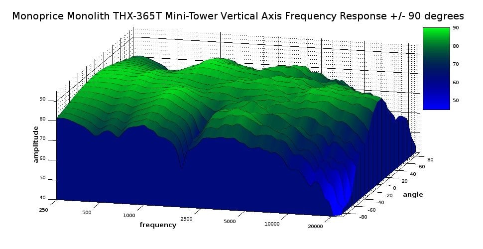

Also, I am also looking at speaker stands for my monolith 365Ts. I think the tweeter is about 13" from the bottom of the speaker, and my ears are about 40" off the floor from listening position.
Am I good to be in the 24"-28" range when looking for stands?
Was looking at the monolith stands because they are relatively cost effective and look decent too. The height options are 24" or 28". Which is better? Tweeter above or below my ears?
The top plates are 8.5" x 6" and the base for the 365T is (semi rounded) 11.5" x 9.5". These stands are apperently good for 75 lbs though which gives me some comfort, as these speakers are over 33 lbs.
I've never had speakers on stands before, do you think this should be ok?

For the 365T speakers, IF you are going to be using the Atmos section of that speaker, I would mount the speaker so that the listening position ears are a bit below tweeter level. If you are not going to be using the Atmos speakers, I would arrange it so that ear height is level with tweeter or perhaps just a bit above. This graph is illustrative of the behavior of the 365Ts on the vertical axis. It shows that hard lobing nulls don't even really start until 40 degrees off axis, so it doesn't matter that much where you sit on the vertical axis, so long you are in a 30 degree angle, which is very likely the case. However, if you use the Atmos speakers, you want as little of their sound to reach your ears directly, and so you should be as far off the vertical axis of those while still getting a good response from the main speakers.
J
JRED 1219
Don't think I will use the upfiring speakers other than to test them out. I would rather just have good clear sound directly pointed at me...
What about the size of the top plates? These speakers will extend 3" over the edge of the top plates of most stands on all sides.
As you know, these are rounded and finding an exact fit is impossible. There are some stands with larger top plates, but the selection is limited.
