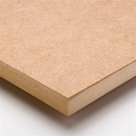

MDF means 'Medium Density Fiberboard', but if you do a search for 'MDF', you'll see photos that show a wide range of colors and particle size. All building materials will show various specs, like density, stiffness, etc- use those if you want a good result.

Do you have them make a couple of cuts for you, or do you hoist the whole sheets by yourself? Fun, eh? 105lb/sheet- awkward, yet bulky.
If it looks like the MDF in the photo, you should be OK. BTW- it withstands water contact pretty well, too- far better than particle board.

It's not that bad- the photo I posted shows a thin layer at the surface- that's where the glue and fibers form a skin, which is pretty durable. It won't shed dust unless the edges are exposed and they're disturbed.
