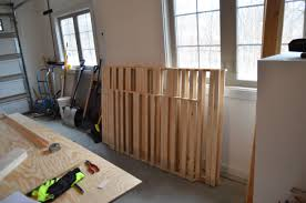

Slats:

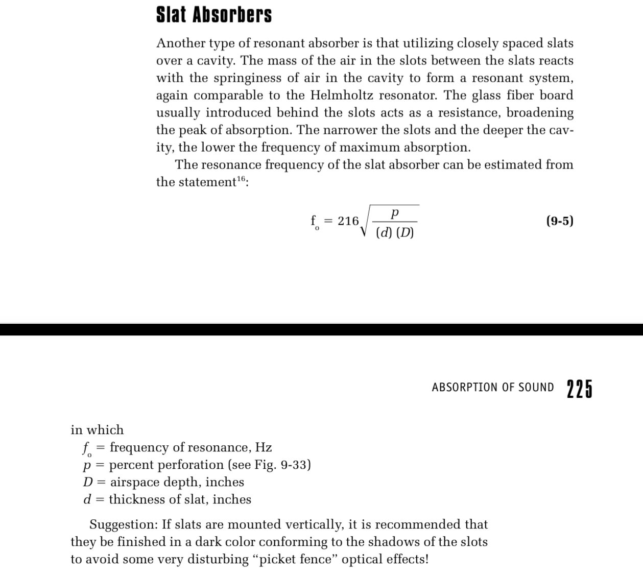

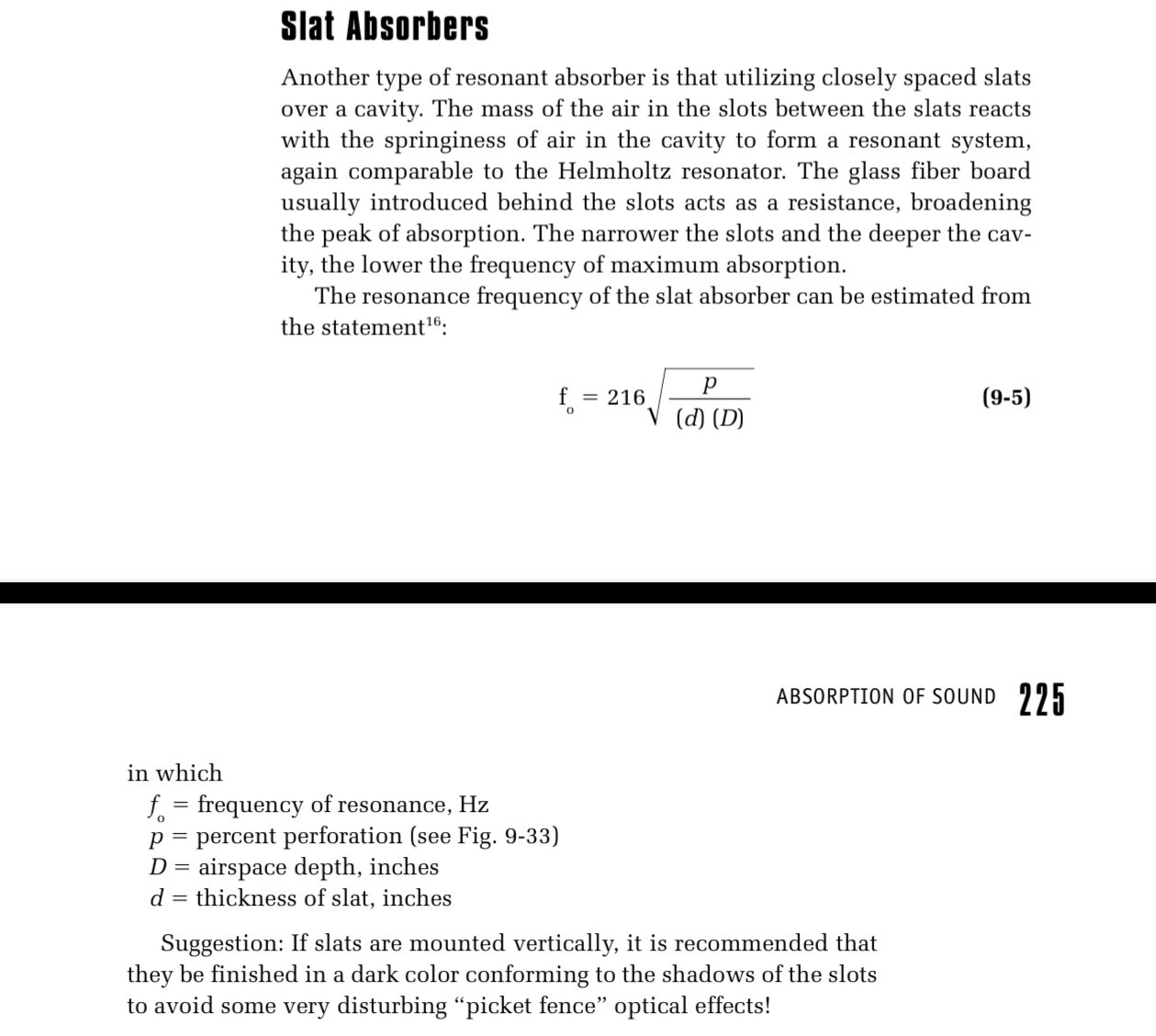

BTW- if anyone wants to look for the Master Handbook of Acoustics, search using the title, or the author's full name, which is F. Alton Everest. Alton is the middle name.
