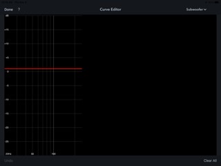

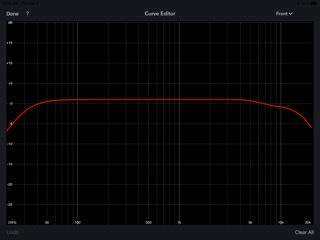

Hi. I bought a SVS SB-2000 PRO about a month ago. I have been really enjoying the sub but find myself spending hours adjusting the parametric EQ getting the bass just right.
My setup is a RXV-779 reciever. Yamaha NS-777, 444, 333 speakers and the SVS SB-2000 Pro subwoofer. My room is kind of small, its about 2,5 meters from the listening position to the speakers. I´ve been using YPAO to setup the system and the EQ on the reciever was automatically set to flat, with a 80hz crossover, speakers on SMALL.
Right of the bat with no EQ i have a huge boost at around 50hz and a smaller boost at around 80hz. From 45 and downwards its loosing about 10db which is very noticible.
I´ve been trying different positions for the sub but it doesnt seem to matter, the boost is still present at 50 and 80hz and its loosing alot at the bottom.
I´ve also spent hours on hours with the parametric EQ app and this is how it´s setup right know.
Screenshot_20210302-113445.jpgScreenshot_20210302-113440.jpgScreenshot_20210302-113434.jpg
With the EQ i have been striving for a linear response, its within +-3db from 80-40hz right now and its loosing 1-2 db going downwards and at around 25hz its boosting a little bit 2db maybe.
I find that rap music with really low bass sounds better now but because of the negative boost in the 50-80hz range most music with alot of mid bass sounds kind of flat unless i crank the gain up alot on the sub but then it´s just to much for it to handle at the lower frequencies 20-40hz.
Two pictures of my setup.
Any tips of what i should do? Just live with it until i move or can i fix the problem in some way?

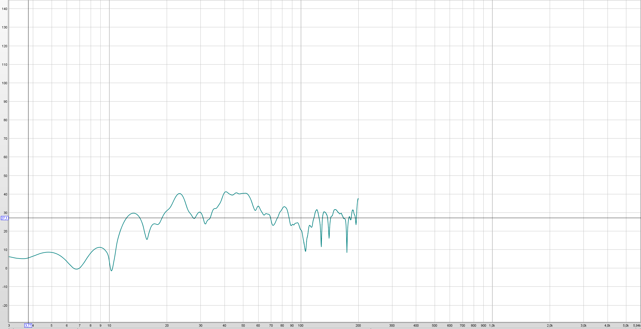

I ran REW with my microphone from my gamingheadset, no idea how accurate that is but the peaks and dips seems to be in the same places as i measured with my phone.
First of all, your gaming headset mic is very much the wrong kind of mic to be measuring this stuff. You need a measurement mic. Here is one that is not very expensive. You also need to narrow down the view of the window. In the upper right-hand corner of the graph screen, there is a button labeled 'limits.' You need to use a 50dB window on the Y scale and a 10Hz to 150Hz limit on the X scale. It's not easy to make out what is going on in your graph because the scales are too large.
Those need you to fuss with phantom power and all that, don't they? Wouldn't a USB model be better? The Dayton UMM-6 is the usb equivalent https://www.parts-express.com/Dayton-Audio-UMM-6-USB-Measurement-Microphone-390-808
You are right, I didn't look close enough. Good catch.
Get the USB one, not the passive one that I linked to!
Amazon doesn't seem to have the UMM-6.....but for Dayton I'd generally buy direct from parts-express.com anyhoo.

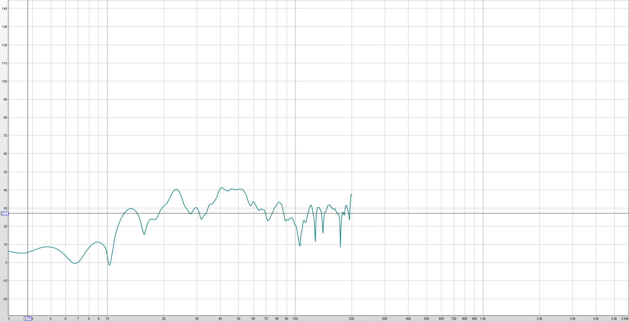

So have recieved the minidsp umik-1 and made some measurements.
The purple graph is with some EQ at 50hz.
The question is however. WHY is it loosing so much DB from 80hz and upwards and what is up with the huge drop att 100hz 140hz??
