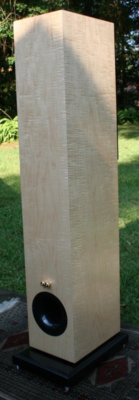

First of all, I would like to thank Gene for making this review possible and Tom for a thorough, well thought out and well written review.
I would also like to publicly thank Dennis Murphy for another spectacular crossover design and Paul Kittinger for his great work on the cabinet design. And, of course, thanks to Martin King for developing the software that made the cabinet design possible. Without the efforts of these individuals, the SongTowers would not exist.
While I could certainly quibble about this point or that, I only have one comment I'd like to share on the review and subsequent discussion. I am somewhat amused by the discussion of TL or not TL. I have had this discussion with a couple of speaker designers in the past and it is purely a matter of semantics.
If you adopt a very tight definition of what constitutes a TL cabinet, the SongTower cabinet may not qualify. But to say that it is simply a standard bass reflex cabinet is certainly not an accurate statement either. If you compare the bass quality and extension of the CA15 in a properly designed bass reflex cabinet with the same driver in the SongTower cabinet, it is quite obvious that there is something very special taking place with the ST cabinet.
Technically, the ST cabinet is a "mass-loaded quarter wave tube." Just as with a more traditional TL cabinet, this design takes advantage of quarter wavelength resonance.
As Gene accurately stated, a classic TL design would require a line length of roughly 7 feet to achieve a tuning of 40 Hz. But as Martin so eloquently pointed out, you can achieve the exact same tuning by using a shorter line length coupled with a mass loading port.
In this case, the line length is tuned to a quarter wavelength resonance of just under 80Hz. The mass loading port then lowers the system tuning to 40Hz.
If you simply change the dimensions of the cabinet by making it shorter and deeper for example, while maintaining the current internal volume, you could certainly end up with a classic bass reflex cabinet.
In this case, the cabinet's physical appearance does closely resemble a standard bass reflex cabinet. But from a performance perspective, it more closely resembles a classic TL cabinet.
For me, there is a simple question that resolves the issue. Is the performance based on helmholtz resonance (bass reflex) or quarter-wavelength resonance (TL)?
Since this design takes advantage of quarter-wavelength resonance just as the most tightly-defined TL design, but accomplishes it in a different manner, I (and many others) feel it is more accurate to define it as a TL variant. But if it makes you happy, simply call it a pseudo bass reflex cabinet on steroids. No matter what you call it, I think we can all agree on one thing - it works.
Thanks again to audioholics for making this discussion possible.
- Jim

In both a bass reflex cabinet and a mass loaded TL, the volume of air in the port acts as a lump of mass. The air in the cabinet acts as the spring, but it is a different spring action in the two types of cabinets. The combination of the cabinet's spring and the mass of air in the port determines the tuning frequency of the cabinet.
If you go back to the yardstick and lump of modeling clay analogy in my earlier post, the air inside the cabinet acts like the yardstick and the port acts like the lump of modeling clay. The air in the port moves in and out, like the modeling clay moving up and down at the end of the yardstick, effectively lowering the tuning frequency of the enclosure.

Jim Salk and Martin King did answer this, but I'll try as well.
A classic transmission line is a straight tube with a woofer mounted on one end and the other end open. The opening is the same diameter as the tube. The tuning frequency determines the length of the tube. This can get quite long, sometimes forcing the tube to follow a folded path inside the cabinet.
A mass loaded port on a TL cabinet uses an opening smaller than the diameter of the tube. In the case of the SongTower, the opening is a 4" diameter flared port. From the outside, it looks the same as a bass reflex design, but inside, that port is a lot shorter than in a standard bass reflex cabinet. This allows the cabinet to be shorter (46" for the SongTower) than with a classic TL opening.

I ran across this thread while looking for reviews on Song Towers as I am contemplating purchasing a pair.
Seems I read somewhwer that th hole resembling a port at the rear of a ST is a "vent" and not a port and can therefore be placed close to a wall at the rear. Is that true?
Swerd
Swerd
Seems I read somewhwer that the hole resembling a port at the rear of a ST is a "vent" and not a port and can therefore be placed close to a wall at the rear. Is that true?
Yes, that's true. Someone asked that in the thread where I posted my ST listening impressions. Dennis Murphy answered.
Others (including myself) have also tried the same thing and heard similar results. This is the opposite of the usual conventional wisdom that has it that placing speakers closer to the wall behind them makes them sound boomy or muddy, and that moving them away from walls decreases the boom. Apparently this feature is also seen in other speakers with transmission line cabinets.
