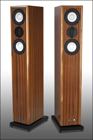

Salk has announced an updated design of the original SongTower. Since it was introduced in 2007, it has been Salk's most popular model.
The new SongTower II retains the familiar MTM design in a tall, slender, floor standing cabinet, with mass-loaded quarter-wave transmission line alignment. The drivers are new. The 5" mid-woofers have ceramic cones built by SB Acoustics, and the tweeter is a recently developed OEM Air Motion Transformer (AMT) design, made by Aurum Cantus, that drastically lowers the cost and size of this type of tweeter. Dennis Murphy played a large role in selecting these drivers, and designing the crossover for them.
The Salk web page doesn't yet show this model, but it definitely exists.

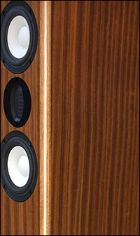

Thanks for posting that Swerd. I hadn't seen the announcement. Just one minor comment on the tweeter. Aurum Cantus didn't lower the cost of producing this type of driver. It was kind of the opposite. After the patent ran out on the original Heil design, lots of companies jumped in and offered much cheaper versions that ranged from truly awful to pretty good. I didn't think any of the ones I auditioned warranted adoption in my or Jim's speakers until I worked with the AC. It's definitely a cut above the competition both in performance and price, and combines the virtues of a dome (lower crossover point) with an open sound similar in character to a good ribbon. That's why I chose it for my new Mini Moniotor, along with the 5" SB Acoustics 5" woofer, and recommended the same drivers to Jim for a new ST. The woofer is arguably the biggest player in the new Song Tower. When doubled up and firing into a MLTL, it can rattle stuff (like the door of my grandfather's clock) at 34 Hz.

It's the same animal, right down to the custom oval face plate. I felt a little guilty using it since to the best of my knowledge, RBH collaborated with Aurum Cantus in developing this particular AMT. I guess they made the same decision that Ascend made with RAAL (64-10) in not insisting on an exclusivity clause (which presumably would have required a very large guaranteed order.) The only real difference in application is that RBH chose to ramp down the AMT's response, while I thought it sounded more accurate running flat. Just so I don't get an envelope from RAAL with some suspicious white powder leaking out, I think any advantage the AMT has is limited to 2-way applications, where a low crossover point is desirable for a number of reasons. in a 3-way, I still would go with the RAAL (and do).
