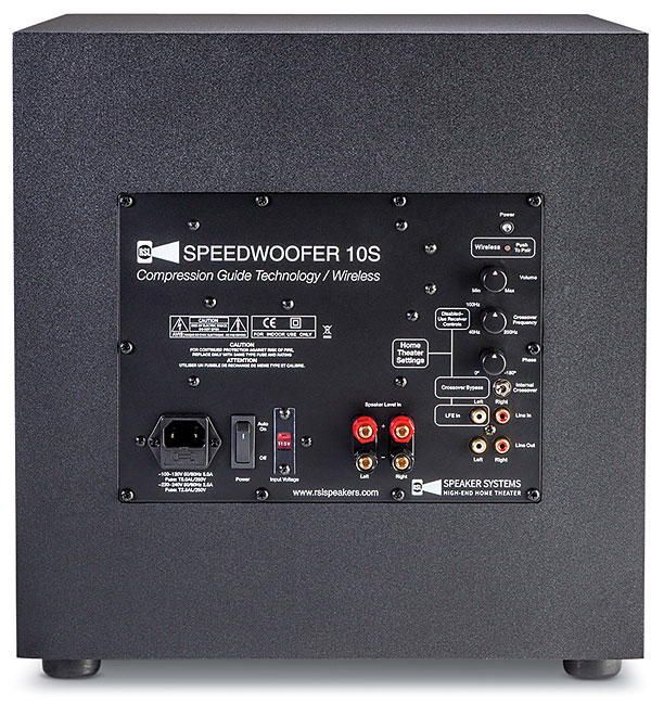

I was looking for a picture to see the controls on the back - surprised that your review doesn't include any!
RSL does not have one on their product page!
Might be good to set up a checklist so something like this does not get missed in the future!
Here is the only one I found (using Google Images):
