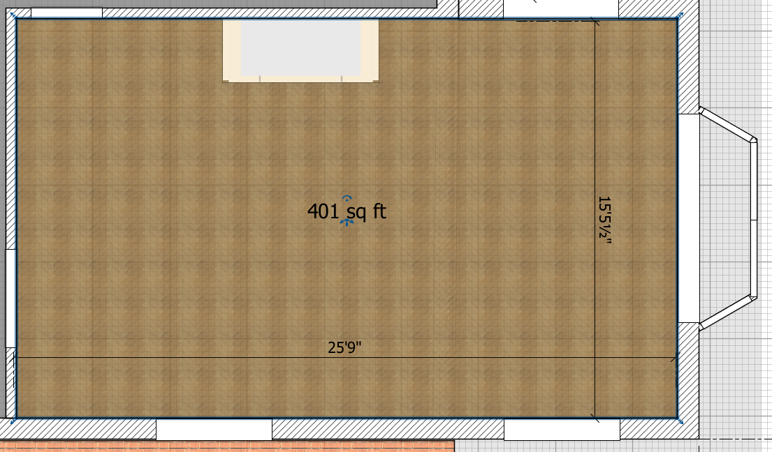

The room is 25'9" x 15'6" x 9' with a large fireplace and a bay window, two openings to the remainder of the house. The floor is concrete covered with wood and area rugs. All windows have cellular blinds (fabric cells with air gaps). There is a love seat and couch which are leather. There is also a over stuffed chair & ottoman. There are various knick knacks scattered through out the space.

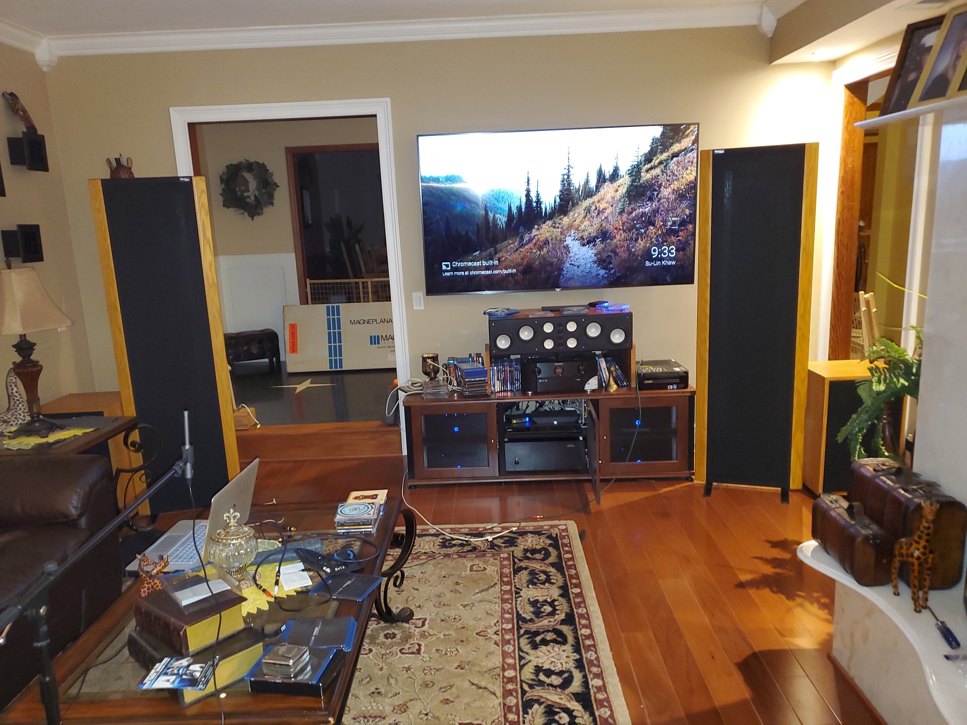

The system is arranged so the TV center & fronts are on the short wall with the openings to the rest of the house. To the left in the picture below.

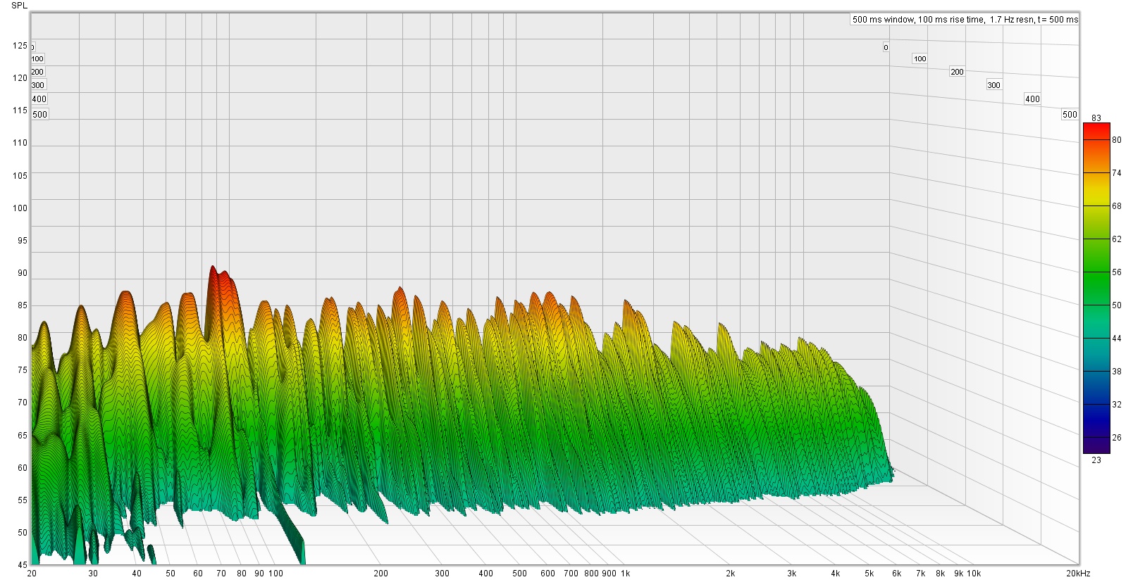

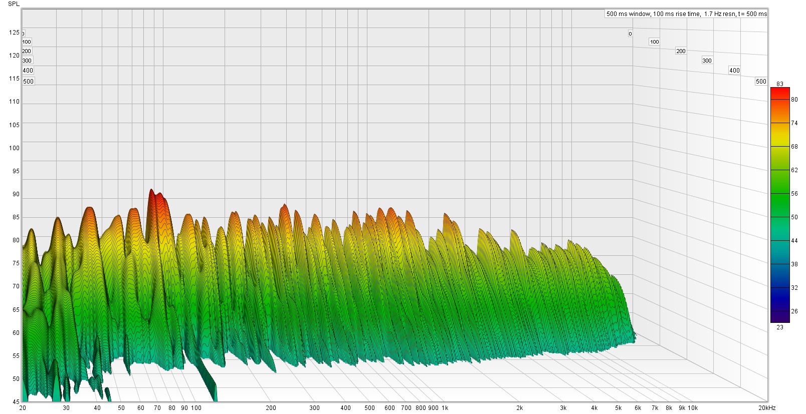

This a waterfall plot from the listening position with just the fronts and all subs playing.
Picture from the listening position.

One of the things I heard in one of the videos Gene has created is that not all corners of a room are excited as much by bass. I sent a 10-200hz signal through my fronts & all subs and found the corner behind my left Front is about 5 DB over the other corners.

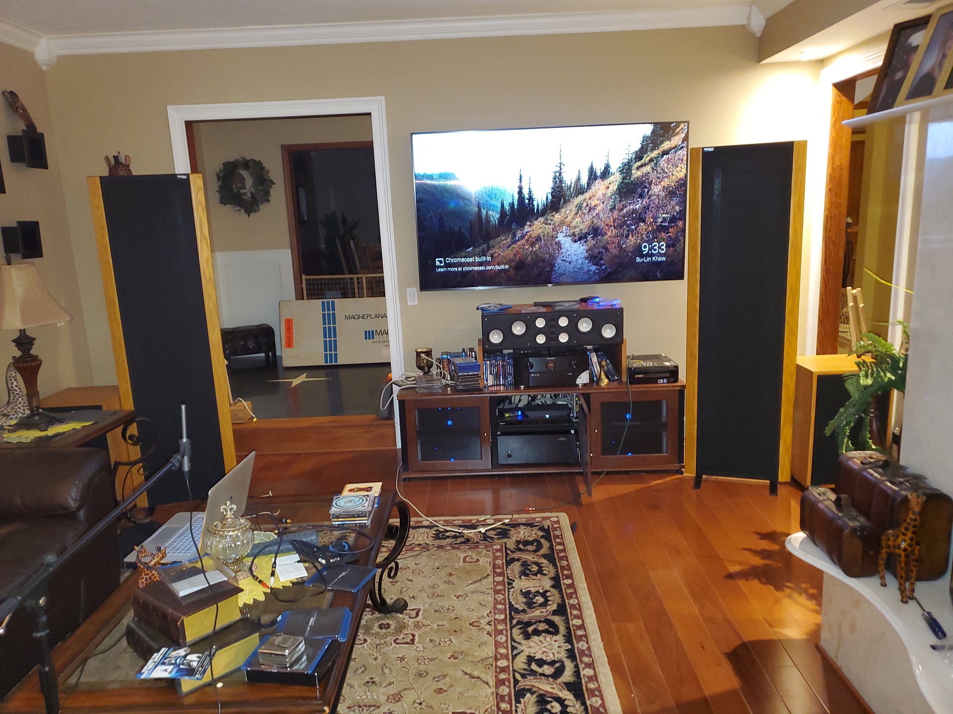

Treating sidewalls would probably be a waste of time with those speakers since they are so directional. If it were me, I would put some absorbers behind the listening position and behind the speakers. I wouldn't worry about ceiling or floor reflections with those speakers.
The waterfall plot doesn't really help much. A basic frequency response sweep with a 50dB window would be a lot more helpful. It looks like the bass is pretty rough in there though. You might want to think about getting an EQ system for the low frequencies.
I have various EQ options available for the bass. but what I am most concerned about on the bass is the decay time below ~50hz.
Regarding the choppiness in the curve above 50hz, I will run tests of individual subs one at a time and see if I can determine which sub or combination of subs are the culprits. Although it could be the 2.7s as they are fairly flat to about 35hz.

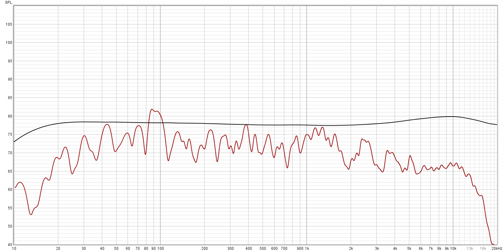

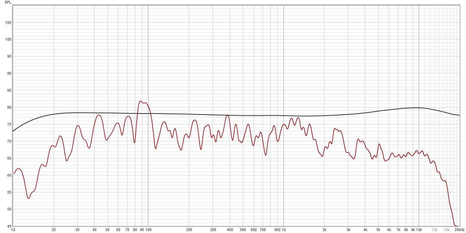

Is this what you would prefer?
The bass decay time below 50Hz doesn't really matter too much. The wavelengths of those frequencies have an inherently long duration. That curve is very choppy though, it is almost as if there is some kind of comb-filtering, like there is a phase conflict. You need to make sure everything is playing together in phase.
That is good, but the Y-axis is still a bit wide. Limit the top of the Y-axis to 95dB.
More like this;
